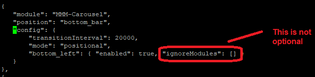

      • K Offline
        khrusher @sdetweil
        OK, I got this to work. there was an error in the console that I chased with some added console logging.
        Positional does work as I had initially thought. I have two modules now swapping out in my bottom_left area.
        The ignoreModules inside the position config is not optional.

          • K Offline
            khrusher @sdetweil
              sdetweil @khrusher
              @khrusher awesome… weird tho…
