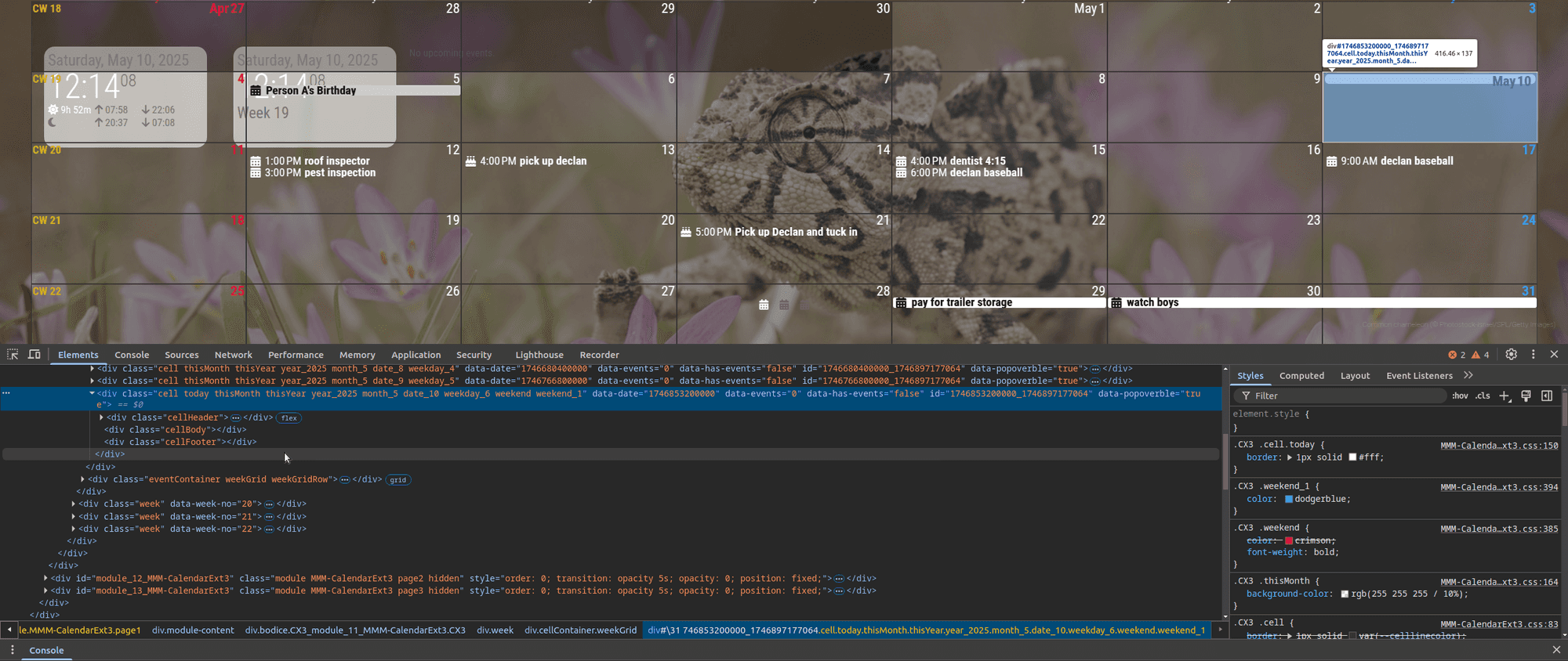

          sdetweil @sankum
          @sankum for the today box
          defined from MMM-CalendarExt3.css
          .CX3 .cell.today {
            border: 1px solid #fff;
          and in the dev window elements tab

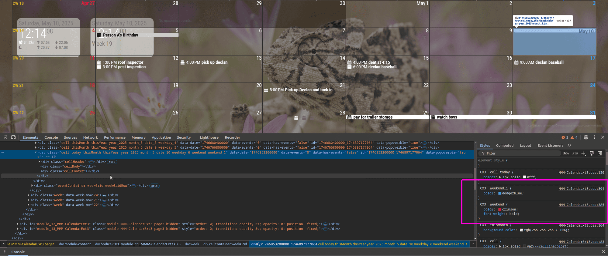

            sankum
            Hi Sam,
            Thanks. I was able to figure out the element and change the background color. I a first time user of the developer tool and so a little confused.
            The background color was not declared in custom.css, is that why they are crossed out in the web developed element? See the image at the end.
            Also is there a default setting in web developer which I can resort to, after I have changed things around and clicked on several things not knowing what I am doing!!?? Thanks.

                  sdetweil @sankum
                  @sankum just for discussion on a couple points from your image above
                  in the css stack pane on the right, you see
                  .CX3 .weekend
                  has a couple styles, specified in MMM-CalendarExt3.css, line 385
                  and one of those styles has a strikethru, color
                  an item higher up in the stack list, also shows a DIFFERENT class
                  .CX3 .weekend_1
                  that ALSO specifies the same style, from the same file but line 394 (further down is processed later, so it overrides stuff set ABOVE this line…(cascading)
                  so you can see the style(and where its set) , see it is overridden(and from where)
                  and the element selected (left side of element view) shows BOTH classes applied
                  NOW , this second style setting/weekend_1 demonstrates a problem, as you MODIFIED the module shipped file of css settings… and next time the module wants to update, it will FAIL as you changed one of ITS files…
