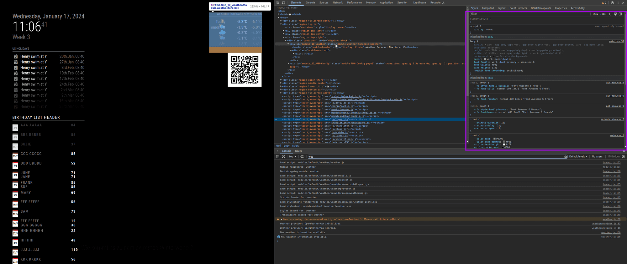

      sdetweil @mischag
      @mischag when that element is selected in the html view, in the right pane is the set of styles applied
      top is most current, further down are prior styles, set or overridden strike thru if overridden, by something later (higher)
      those sections also tell you WHERE the styles came from (file)
      S M 2 Replies Last reply
        @mischag see this image the pink section

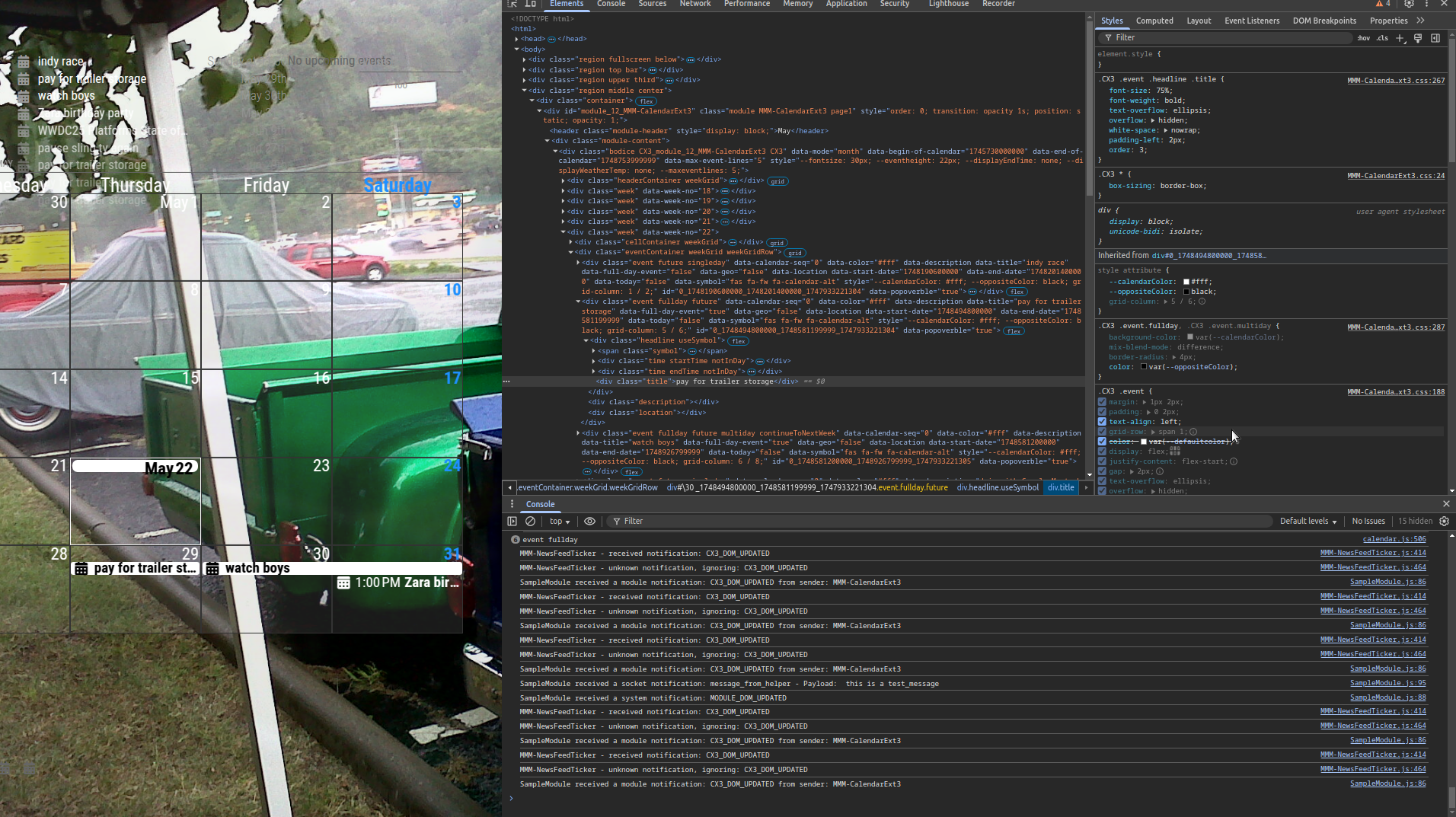

              • M
                mischag @sdetweil
                mine looks like this…
                Screen Shot 2025-05-23 at 1.06.42 am.png Screen Shot 2025-05-23 at 1.06.31 am.png

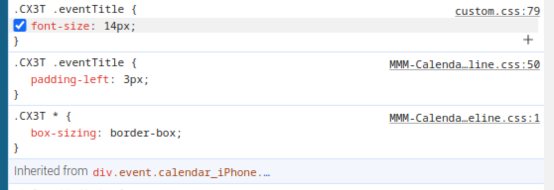

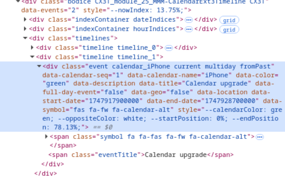

                  sdetweil @mischag
                  @mischag click on the span with the text "calendar upgrade "
                    from one of my cx3
                    M 1 Reply Last reply
                    • M
                      mischag @sdetweil
                      Yeah, ok. I’ve clicked on that span line with the text…
                      Then down in the ‘style’ section this is what’s showing…
                      I’ve changed the font size in the custom css but it’s still not showing anything…
                      Thanks again. It’s really got me stumped.
                        sdetweil @mischag
                        @mischag ok, color, opaqueness
                        whats above that fontsize custom.css was used
                        didpkay:none; would hide it too
