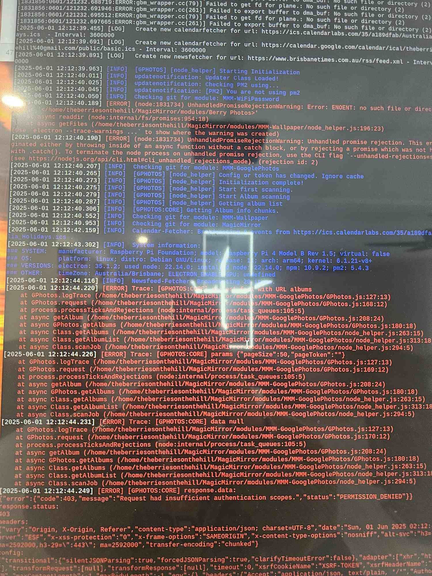

      Hi, I have updated the module using
      cd ~/MagicMirror/modules/MMM-GooglePhotos
      git pull
      npm run install-prod
      And when I go to run the magic mirror my photos don’t load it says in the bottom right corner loading from Google Photos but never loads any photos!
        sdetweil @Rberry91
        @Rberry91 google changed the way photos works.
        You need to use their app to select photos to view
        And we don’t know how that translates to
        MagicMirror api call
        So the module doesn’t work currently

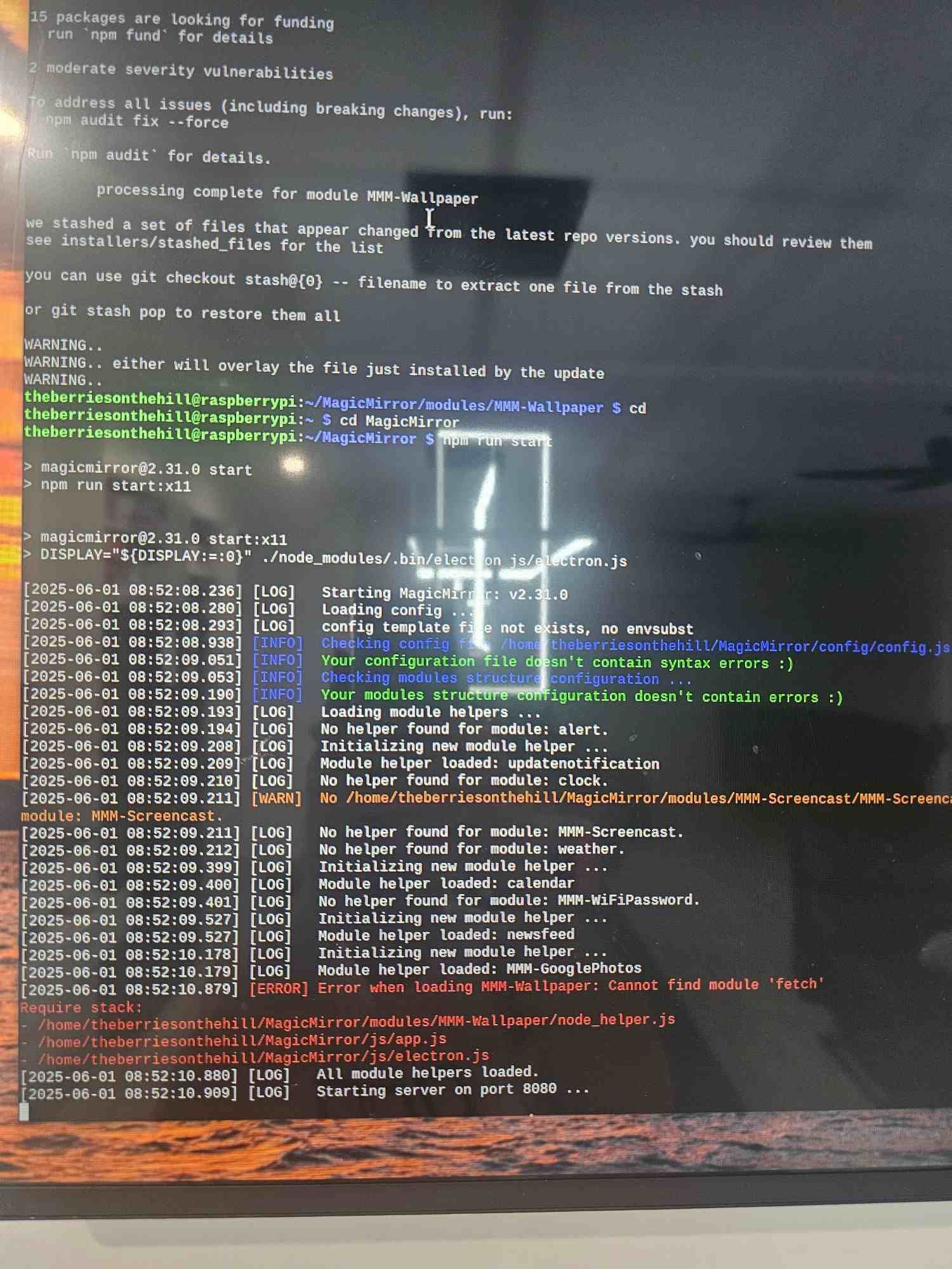

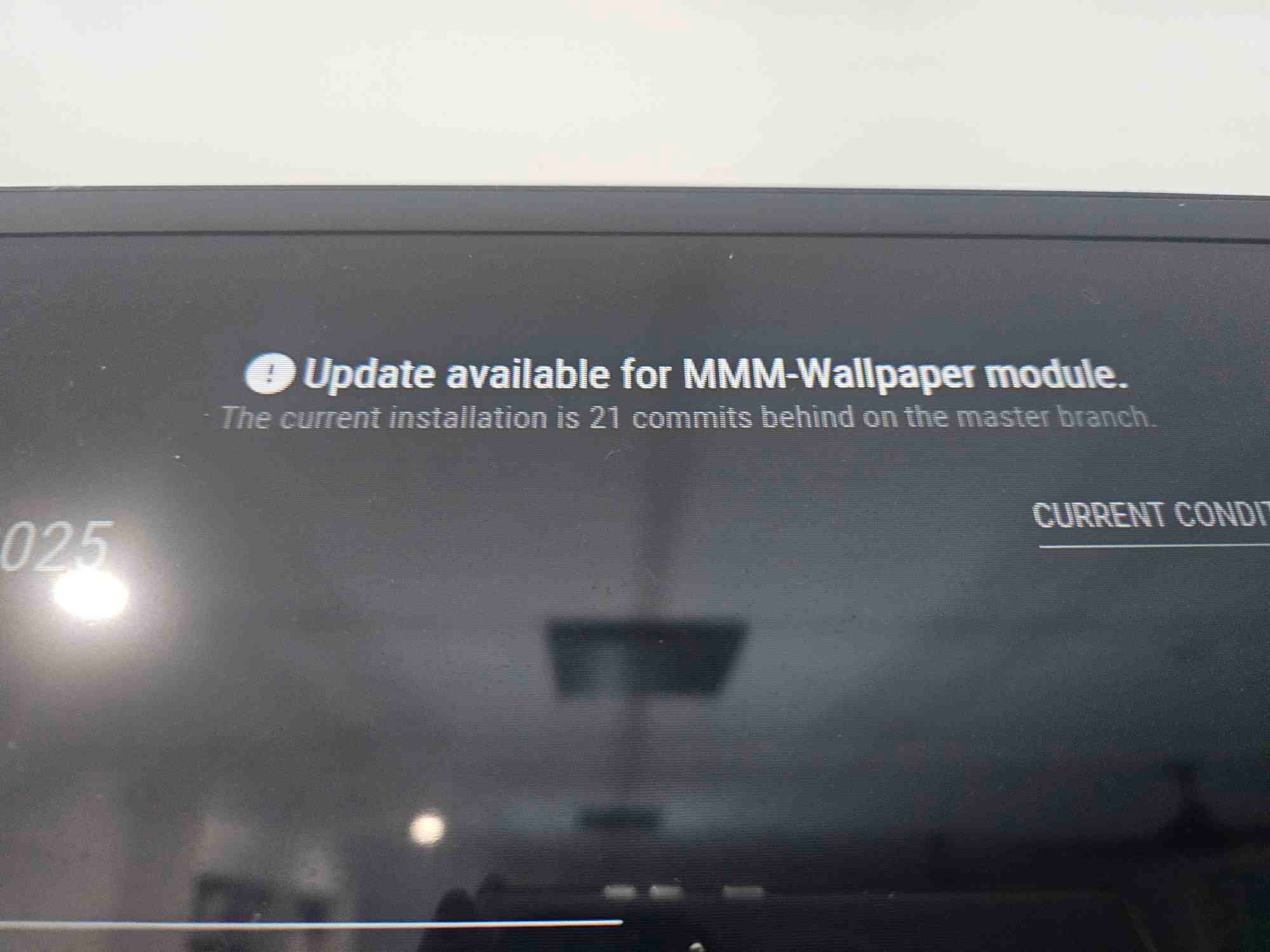

          So I have added MMM- Wallpaper but I get the error "Cannot find module “fetch” and also “update available for MMM-wallpaper” I believe i have updated using your code but still get these errors!20250601_085211.jpg 20250601_085404.jpg
            sdetweil @Rberry91
            @Rberry91 I do not provide a module update script
            You have to go to the module folder in terminal and do git pull

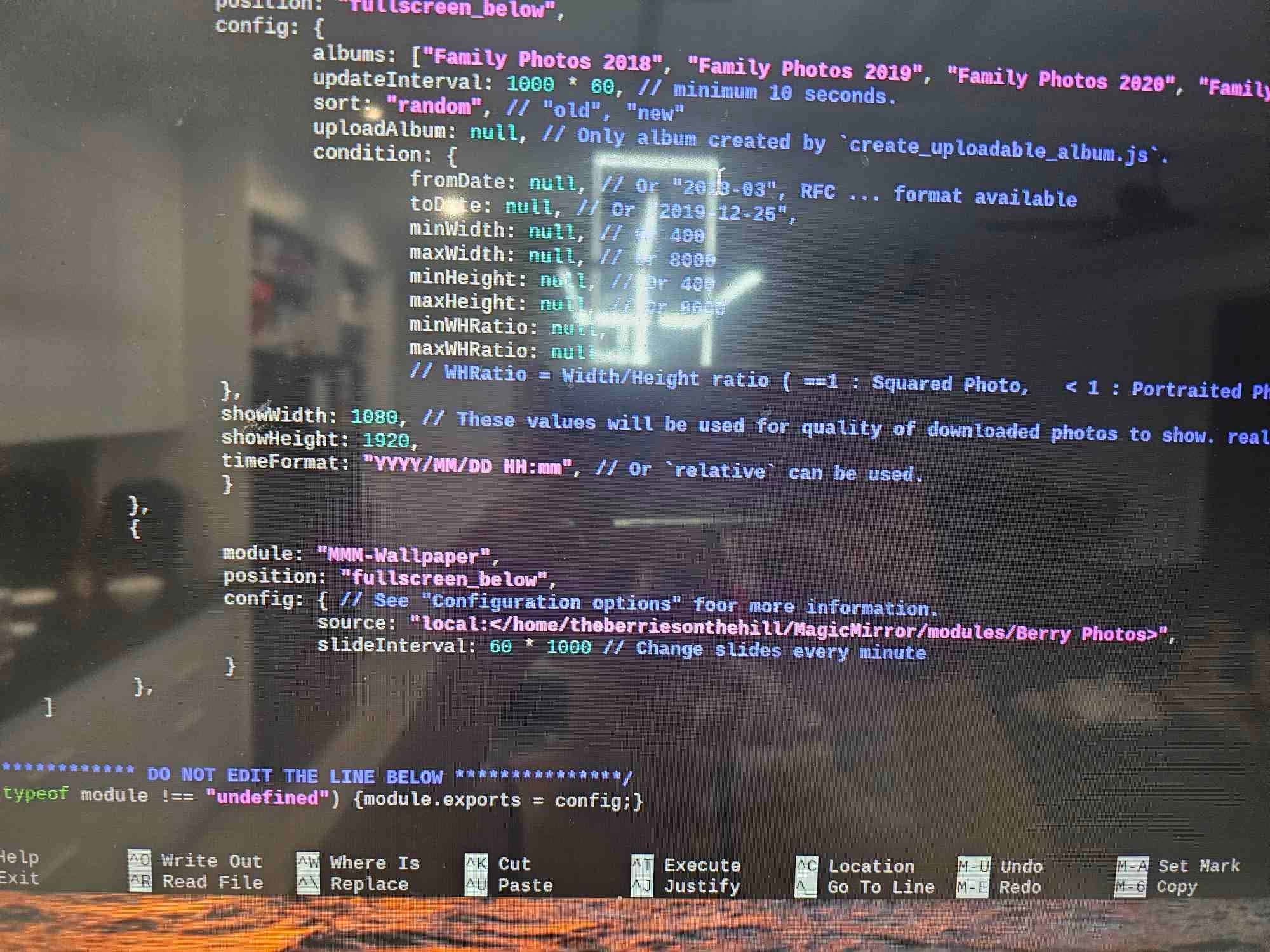

                        Photo of script
