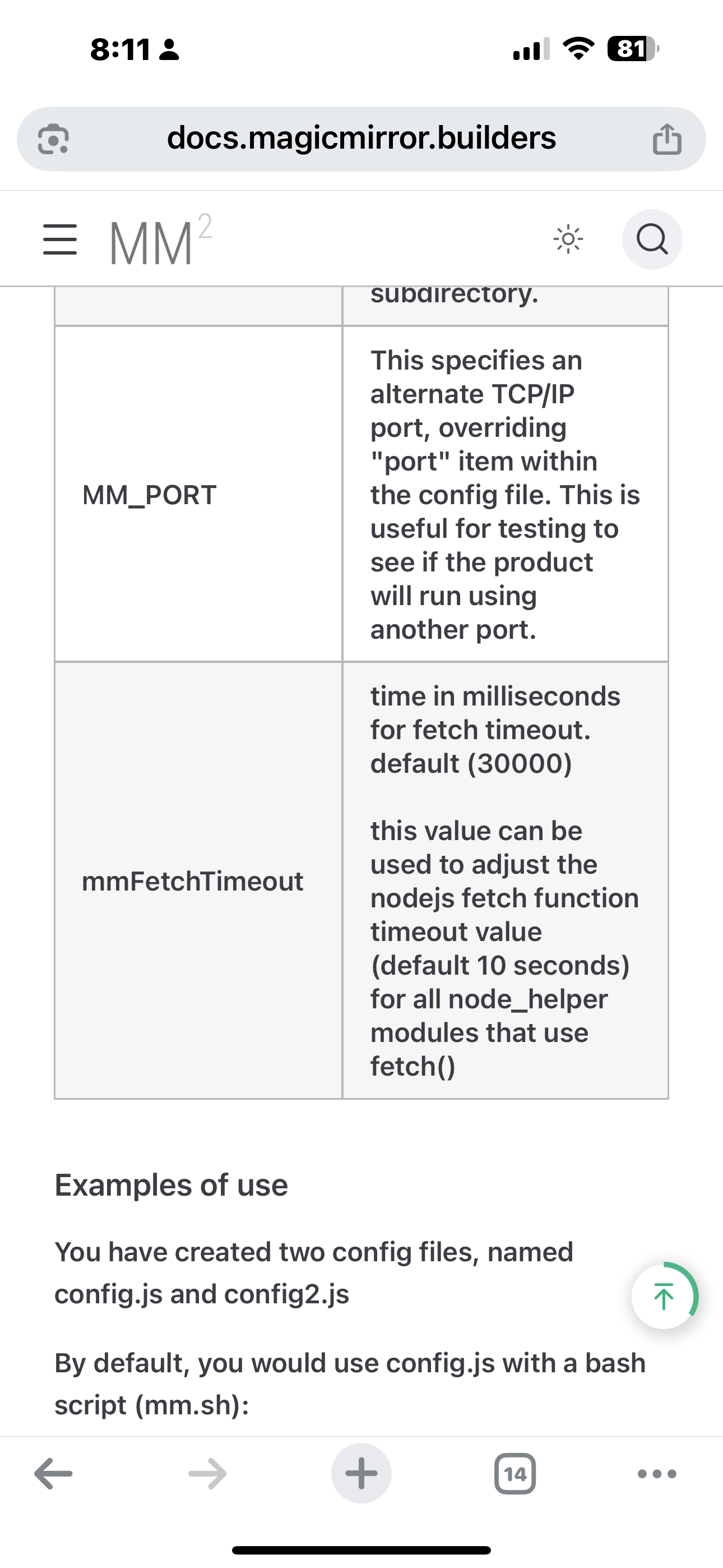

          @nowayto what version of MagicMirror are you using.
          I added a feature to be able to control that timeout, but set the default at 30 seconds
          See the doc, configuration, mm FetchTimeout environment variable
          But the code should recover by itself.

            sdetweil @nowayto
            N N 2 Replies Last reply Reply Quote 0

                        • N Offline
                          nowayto @sdetweil
                          I’m sorry Sam, I didn’t figure out where I have to configure the
                          mmFetchTimeout. Where is it located? Thanks
