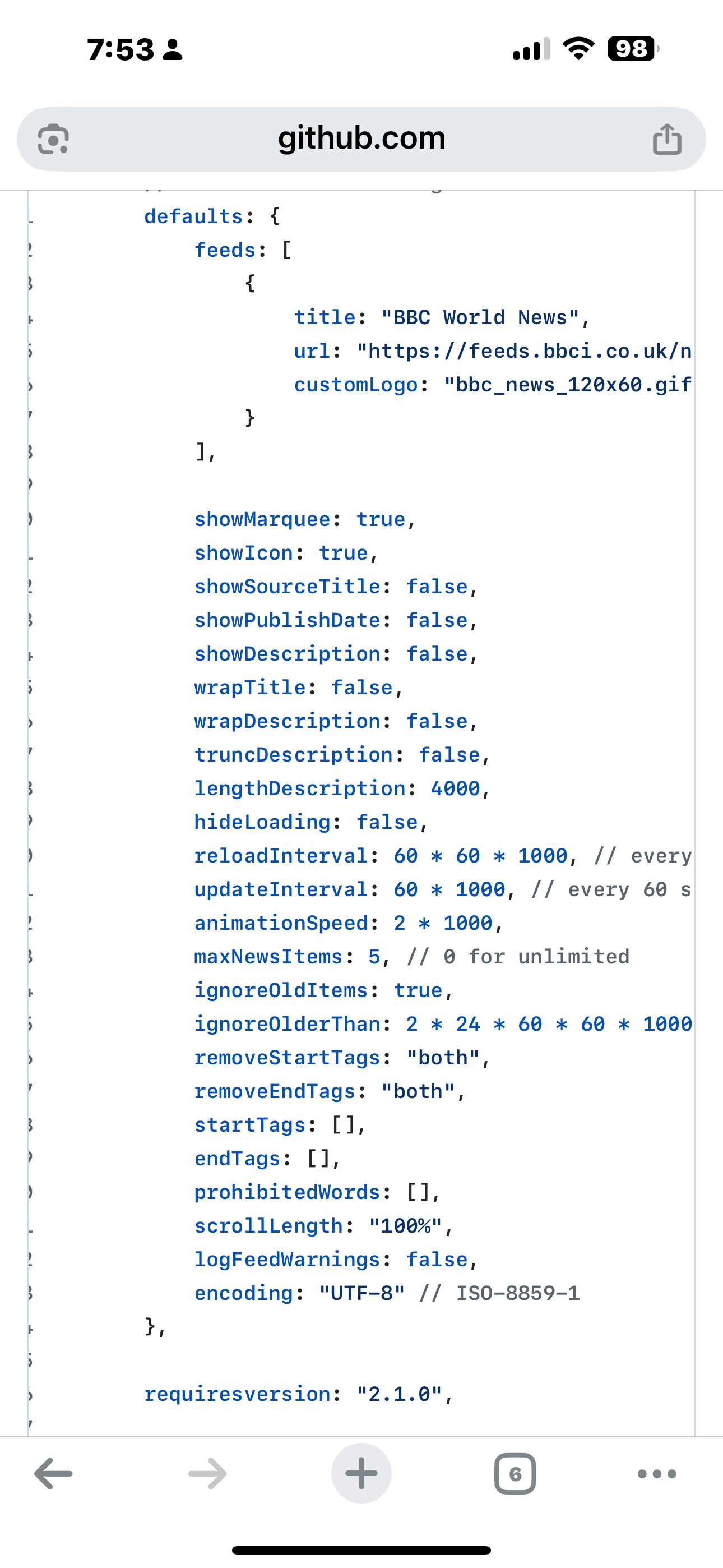

      I’m using NewFeedTicker for my local news RSS feed. Is there a way to get just the headlines and not the start of the article? I’m still trying to figure out some of the timing and would prefer to see more headlines and less from the actual articles. I don’t see anything about it on the github page. Any suggestions are welcome. THX

          I appreciate your help. I just want to display the headline and not the start of the article. But I have not seen anything that I recognize as controlling that as a feature.
            sdetweil @RonR
            @RonR there a bunch of config options not listed in the readme
            i think
            showMarquee:false
