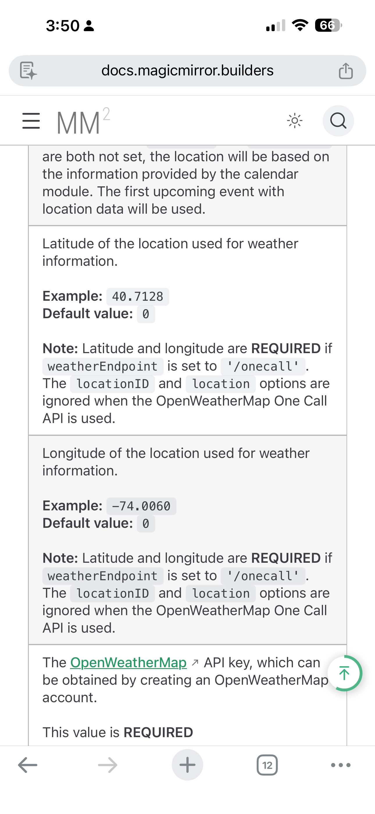

        sdetweil @MikeTheYeti
        @MikeTheYeti the settings for open weather use the lat/lon
        Properties now, w endpoint /onecall as the default
              Also see
              https://forum.magicmirror.builders/post/124671
                MikeTheYeti
                Thanks! It works!
