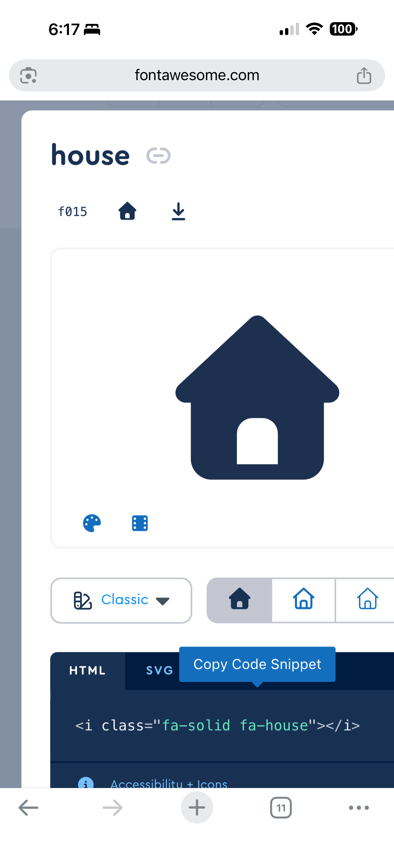

          When using the font-awesome set,
          They give you a name or a number, you can use either value
          I dont know the set you picked
          Fa house is ‘house’ or ‘\f015’
