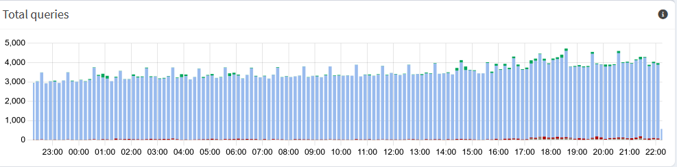

          @sdetweil Commenting out the calendar module in config.js doesn’t stop the network traffic until a reboot, after which it’s silenced.
          Interestingly…the problem appears to grow with time. Looking back 24 hours ago, MM was around 300 requests per minute, and now it’s averaging about 400:
