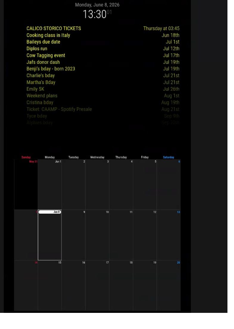

      I added a couple of ‘blank’ pages in between my pages with content and since doing that, none of my calendar events are displaying on the calEXT3 module.
      Previously, I had two pages both with content and it was working fine.
      I now have a blank page, content page, blank page again, and the final content page with calEXT3. Since adding those blank pages, the calEXT3 module is empty but all others are reporting ok. The default calendar module is still loading the event stream fine, but nothing makes it to the calendar display. I tried reducing to just a single calendar, no help. I also tried going back to the ‘old’ setup with only 2 pages and it still didnt display anything.

      • K Offline
        kkmirr04 @kkmirr04
        I figured this out - I’m an idiot.
        I forgot I added a space after my calendar name under the default calendar module so that the displayLegend option would look a little cleaner formatting wise. I never added that space after my calendar name where EXT3 calls for the calendars you want to display. Once I added that space back in, everything worked.

          @kkmirr04 ok, the design here is MM calendar module broadcasts events, fairly at random
          CalExt3 (family) consumes those events, and draws new view…
          but it doesn’t want to flash the screen on every event arrival,
          refreshInterval
          sort of like a train station stop, when the interval fires, all the events that have arrived til then are shown
          miss the schedule, wait til next time
          default 10 MINUTES
          but you don’t want to wait at the start for 10 minutes, you want it to draw NOW…
          so waitFetch controls a short wait at startup
          but if you miss that window, then you wait the refreshInterval
          I suspect that if the module is not shown on the 1st page, it doesn’t get its dom created signal til the page is shown. so you have 40 seconds (page 0/page1) til the first draw starts, which is after the waitfetch.
          how long did you wait?? have to wait at least 10 minutes, til Ext3 will draw again

            @sdetweil I had left it running for a few days after making the change last weekend. I’ll restart it again now and give it ~ 30 min before checking again
            • K Offline
              kkmirr04 @kkmirr04
              Its been running for the last ~ 3.5 hours and still no events have displayed on EXT3
                Thanks again @sdetweil for the quick responses!!!
                  sdetweil @kkmirr04
                  @kkmirr04 ah, that’s why I dont use the calenderSet list in ext3 config. Show all
                  Glad you found it!! ( it is there in the config you posted)
