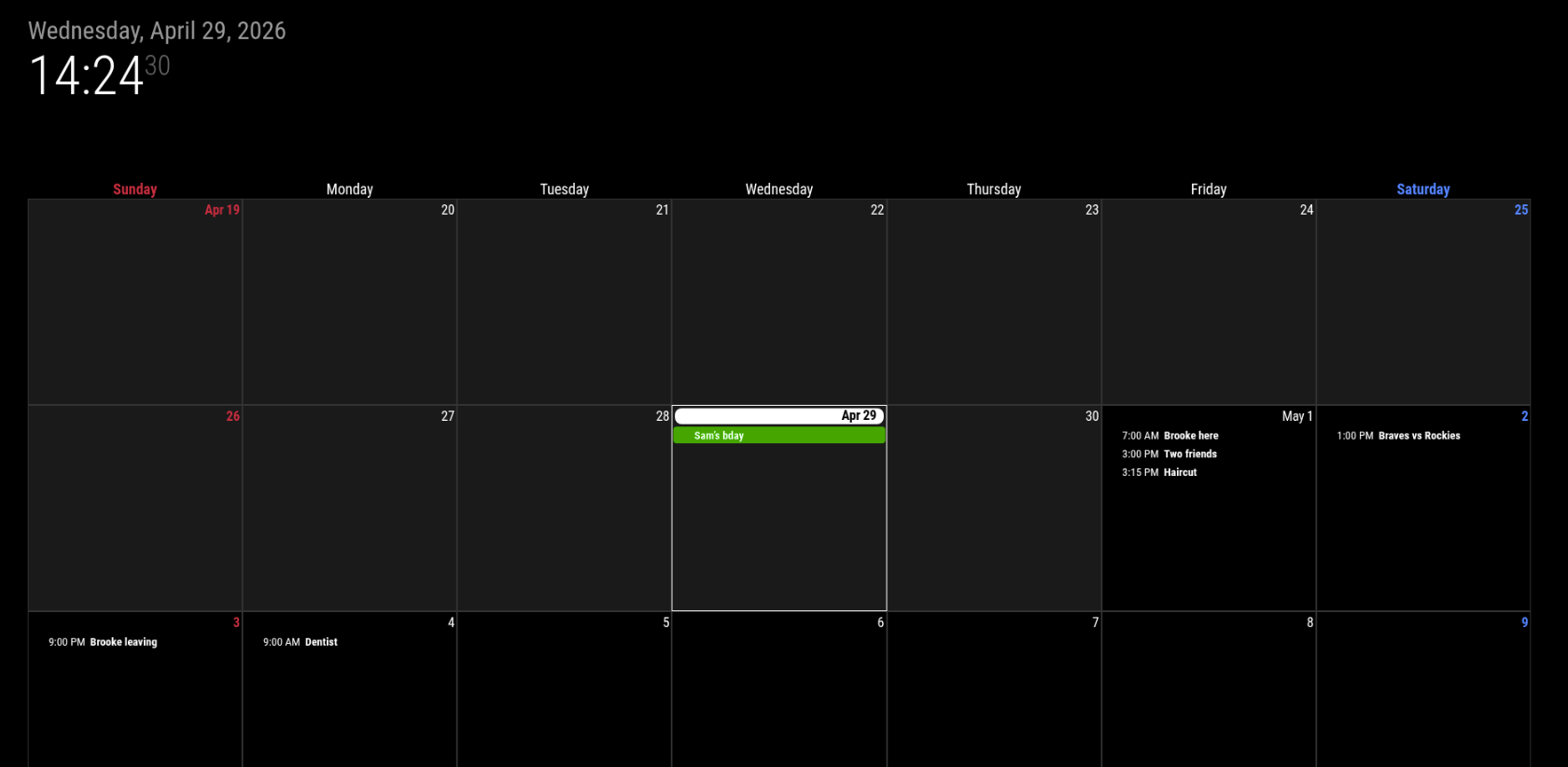

      kkmirr04
    • RE: Apply color to future events in CalendarExt3
      @sdetweil No change unfortunately. Both event streams load fine and with color, but the calendar still is displaying everything just white, except for one event that did come with color 10.png
      posted in Custom CSS
      K
      kkmirr04
      @sdetweil with both disabled it did draw both instances with color
      Then turning EXT3 back on I’ve got no color on any events again
