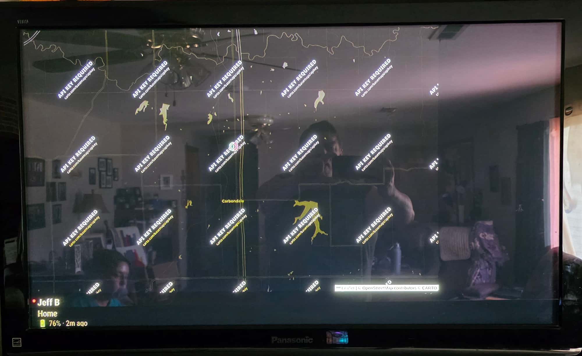

                • plainbrokeP
                  plainbroke @hrmax23
                  @hrmax23
                  Ok got it working.
                  But I am getting this on my screen instead of the map.
                  Ideas???
                  Slow learner. But trying anyways.
                  MM is on Raspberry Pi 4B w/8gb ram loaded on a 128gb nvme drive.
                  Running Trixie and the latest MM version.
                  H 1 Reply Last reply Reply Quote 0
                  • H
                    hrmax23 @plainbroke
                    @plainbroke are you using the light or dark map in your config? Try the opposite one and see if the behaves the same.
                    plainbrokeP 1 Reply Last reply Reply Quote 0
                    • plainbrokeP
                      plainbroke @hrmax23
                      @hrmax23
                      I think that fixed it, appreciate all the help getting your module setup.
