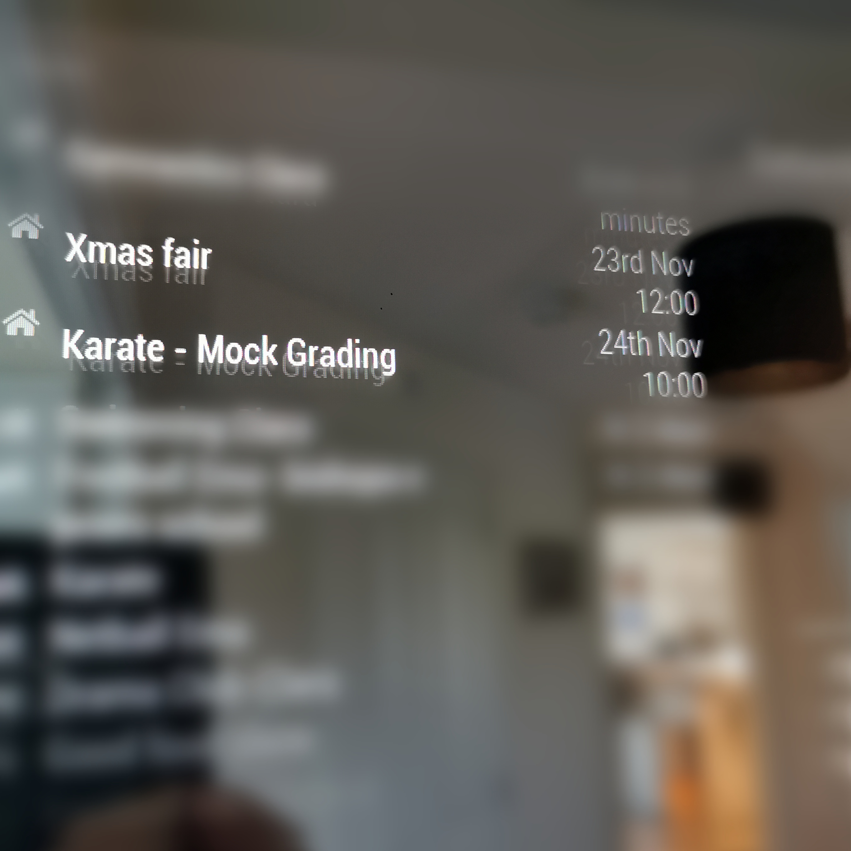

      I can’t seem to make a long events name truncate. Even when the event name is short sometimes the date causes the line to go to double lines like below:
      My code is below:
      		header: "Pedro",
      			timeFormat: "absolute",
      			getRelative: "0",
      			dateFormat: "Do MMM HH:mm",
      			maximumEntries: '10',
      			maxTitleLength: '20',
      			wrapEvents:'false',
      Any help appreciated.
      Cheers,
      Pedro

        Okey, first of, you need to alter your config since as it is now it won’t use your values.
        When the configuration is a pure number you don’t use " or ' you just enter the number.
        The same goes if the options are true or false.
        so your config should look like this :
        		header: "Pedro",
        			getRelative: 0,
        			maximumEntries: 10,
        			maxTitleLength: 20,
        			wrapEvents:false,
        And I don’t get the row break as you do, do you have any other restrictions in your custom.css?

          Yep - you sorted it!
