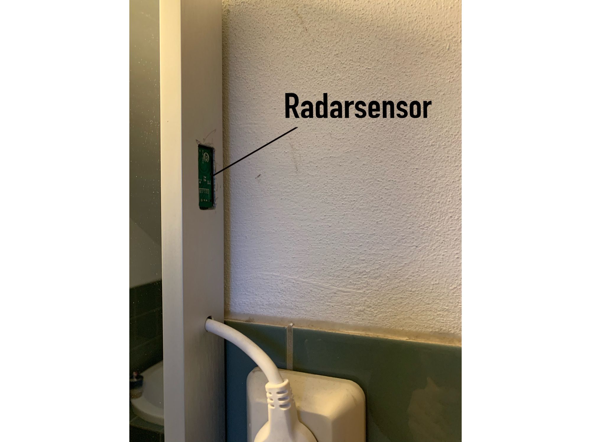

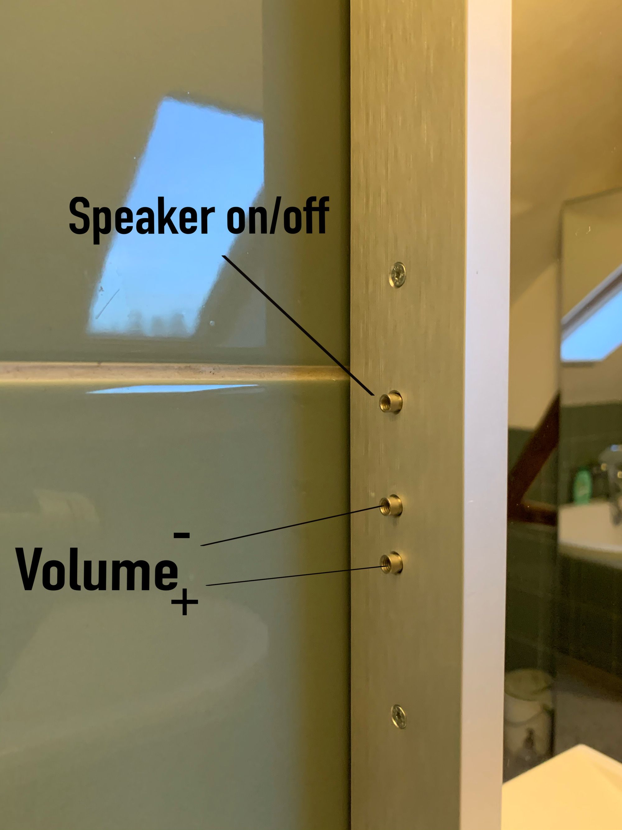

      Hello everyone. Frist, sorry for my terrible english. Here are some pictures and a lot about the hardware.
      • mirrorglass: Mirastar Spionspiegel 4 mm, brigla-shop.de
      • frame: Nielsen - Alurahmen Profil 224 60x80 cm, Silber matt, AllesRahmen.de (depth= 4cm)
      • Radarsensor: RCWL-0516
      • shelly 1pm: is for charging the JBL- speaker, because I can see the amperage in the web interface
