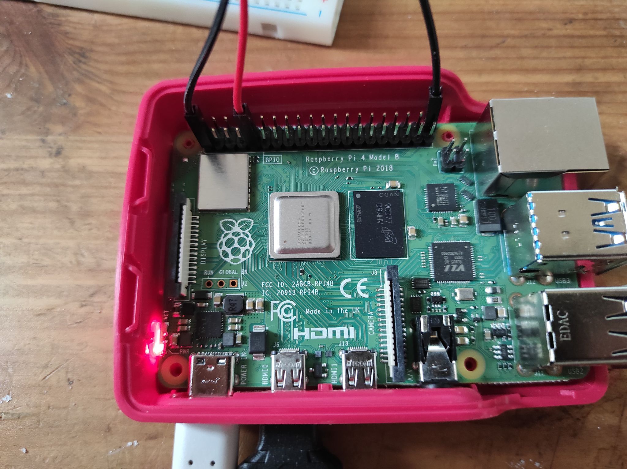

      I’m trying to make a magic mirror as a school project. We are using a DHT-22 sensor to get local temperature and humidity but it doesn’t work. I’ve been working on it for 4 days now and I can’t find any solution :(
      Here is my config.js and how i wired it
      BTW : I have a python script on the py that reads datas from dht 22 soooo ://
      Thanks,
      Ipso

        Update : I’ve tried other modules (dht-22 & DHT-22) but nothing changed :/
        But my script still works so I was wondering if there’s a way to use it in a module ?
        I’m clearly a beginner so I somebody as any clue for me ://
        Ipso

              @jimus888 Thanks for your answer, but still doesn’t work :!
              The module seems to load forever :/
              I’ve tried apt-get update && apt-get full-upgrade but nothing seems to work :/
