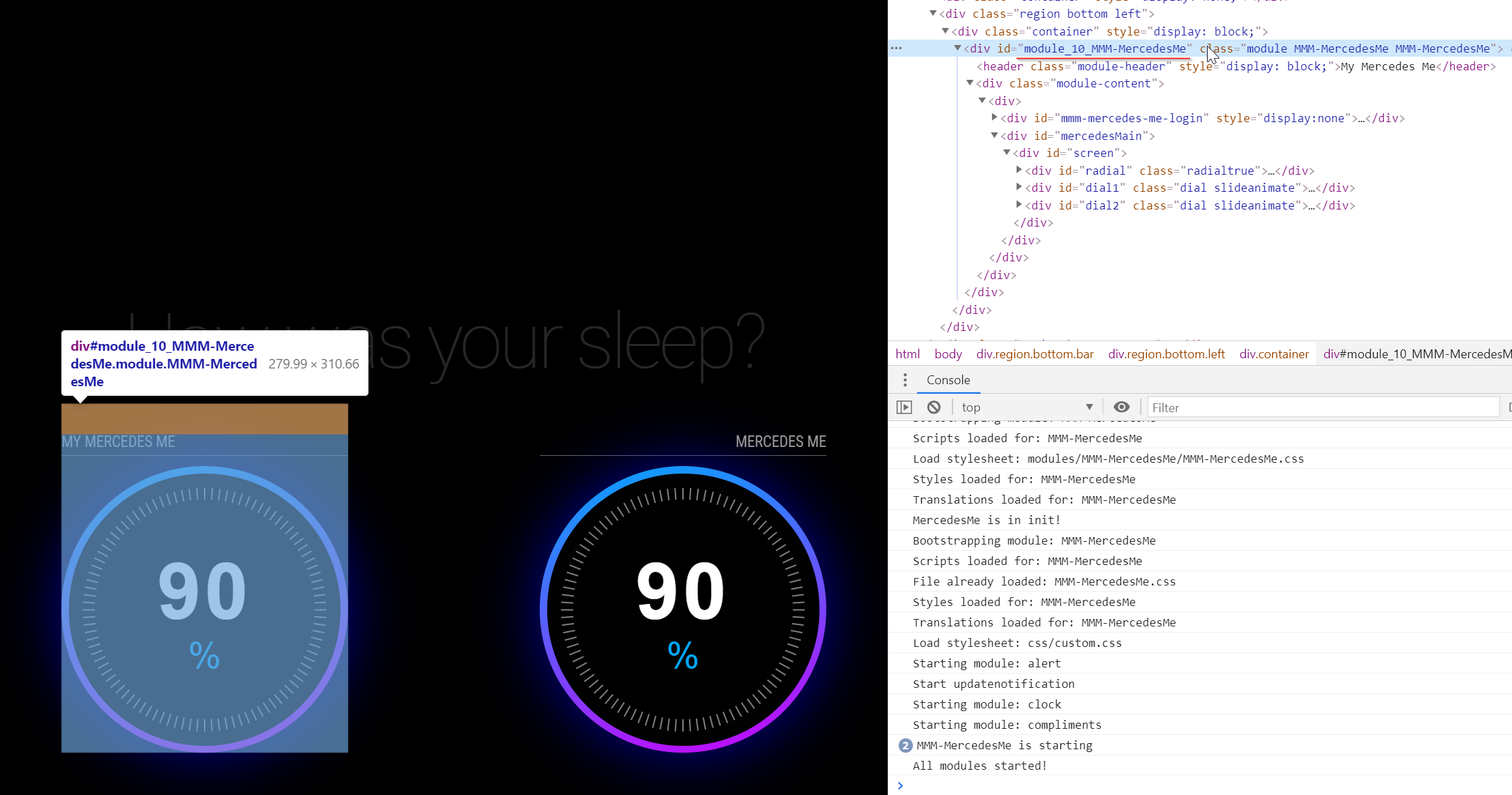

      @tylerj714 if you are not changing the modules in config (including their order) frequently then you can use ID selector of css. Check the ID of the instance in dev tools you want to change and then use it in custom.css. i.e.
      #module_11_MMM-OpenWeatherMapForecast  {
        width: 500px;
      here # is id selector or check if you can play with nth-of-type selector ( I could not get this working)
      T 1 Reply Last reply Feb 8, 2021, 6:01 PM Reply Quote 1

            @tylerj714 Id starts with 1 in MM, but it does not matter. You need to get actual id of the module you are targeting using dev tools.
