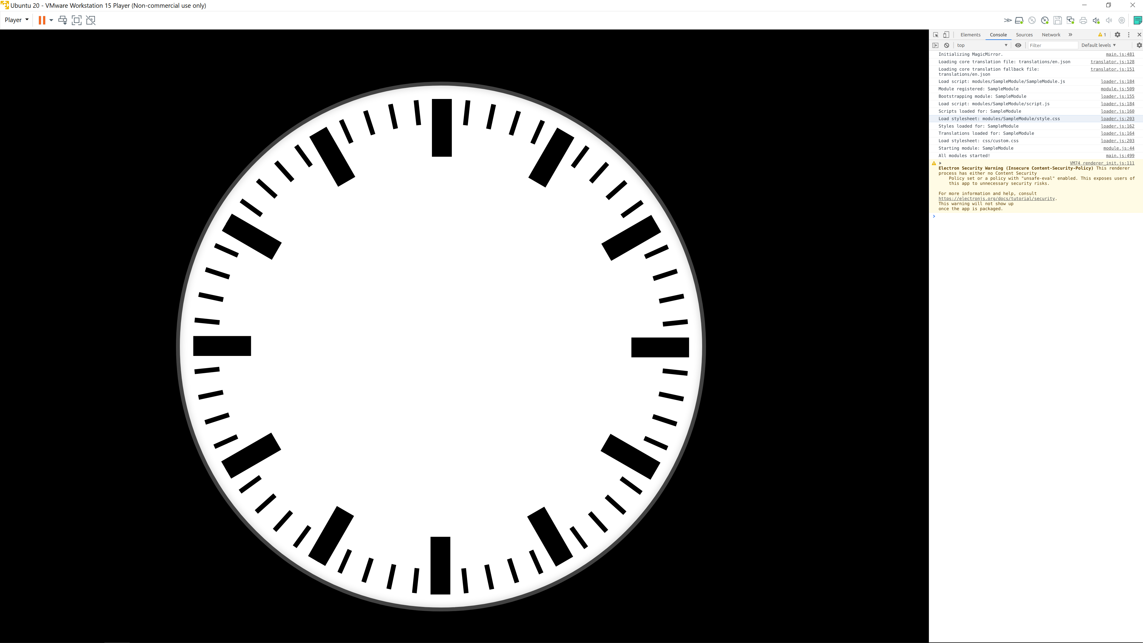

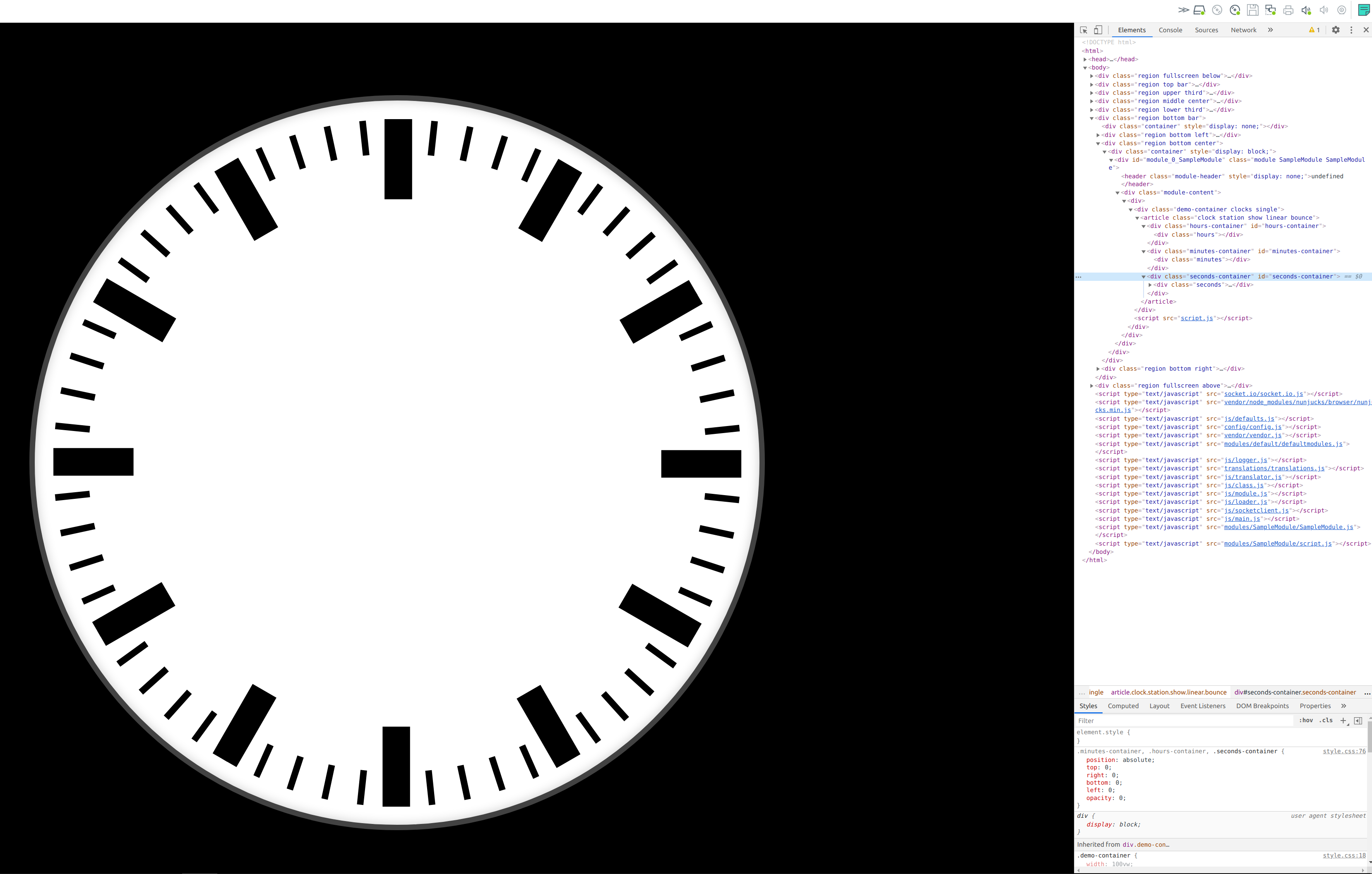

                        @sdetweil I tried but not working, I think something is missing.
                        Anyways, I am just using the default analog clock for now. Thanks for all help. I may try it sometime later. u1.png u2.png
                        S mumblebajM 2 Replies Last reply Reply Quote 0
                          sdetweil @nirvana
                          @nirvana yeh, the code needs to change
                          window.addEventListener('DOMContentLoaded', () => {
                              firstMinute()
                          this will never occur, cause it happened a long time ago in MM web page being loaded
                          u could use notification of DomObjectsCreated to call firstMinute()
                          I don’t know if this is right in MM
                          document.addEventListener("visibilitychange", () => {
                          its the difference between having the whole page to yourself and sharing the space with other modules
