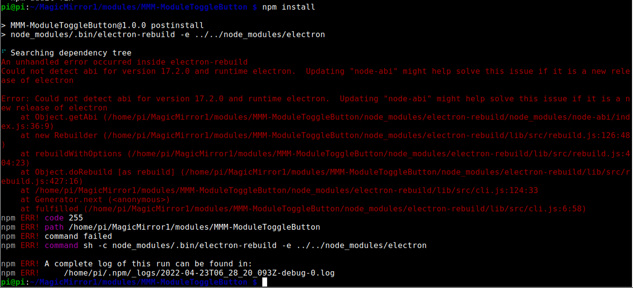

      Hello everyone
      I’m currently having some trouble with the MMM-ModuleToggleButton module
      link here - https://github.com/balassy/MMM-ModuleToggleButton
      I followed the instructions for installing the module however I am getting some errors does anyone have any ideas of what to do?
      alt text

        @mayfield:
        Try this:
        cd ~/MagicMirror/modules/MMM-ModuleToggleButton
        npm remove electron-rebuild
        npm install magicmirror-rebuild
        npm install
        and you will see:
        ✔ MagicMirror Rebuild Complete
        magicmirror-rebuild is @bugsounet an app ;) !
        ( @sdetweil for callback )
        M 1 Reply Last reply
        • M
          mayfield @bugsounet
          @bugsounet Gday mate Thanks heaps that works
