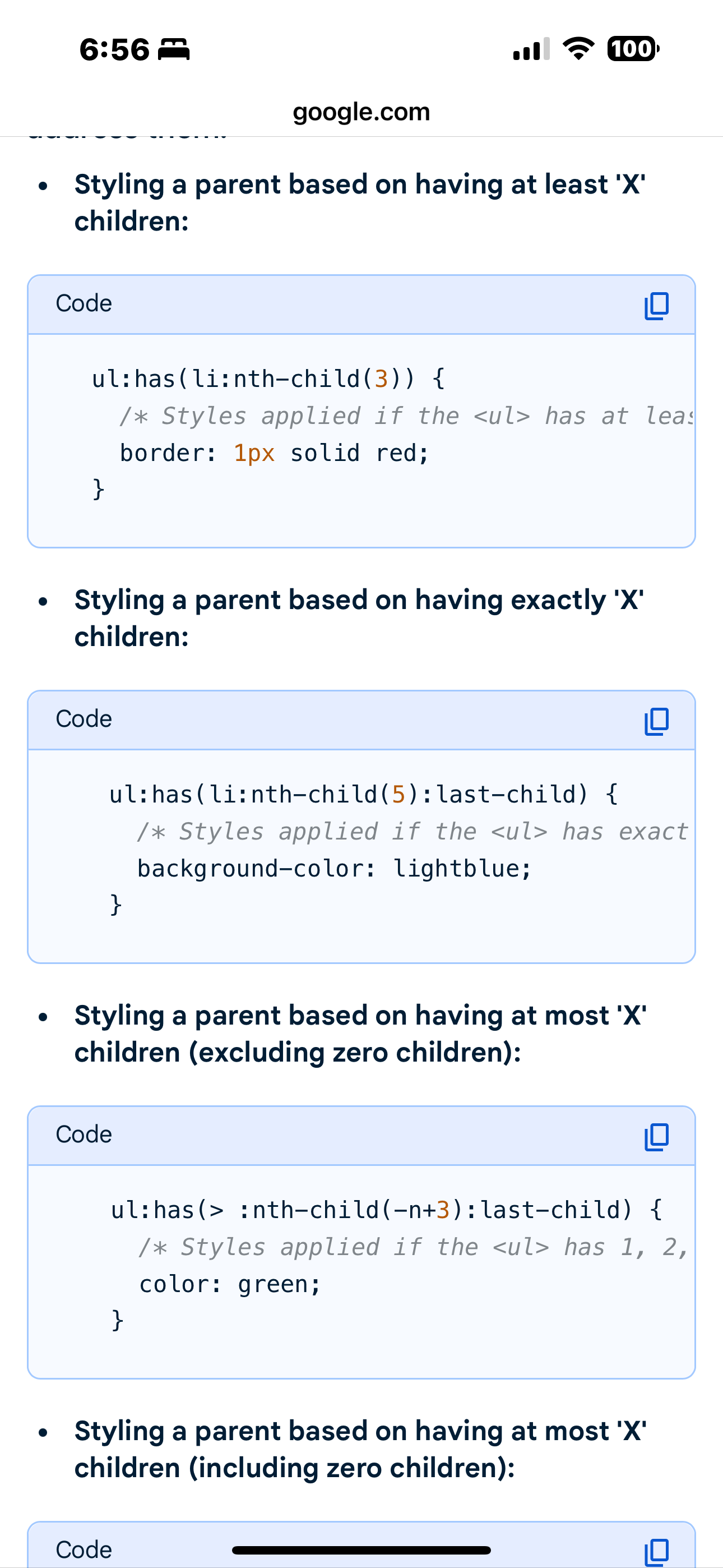

      this works,
      .MMM-CalendarExt3Agenda:has(.agenda:empty){
              /* background-color: red;*/

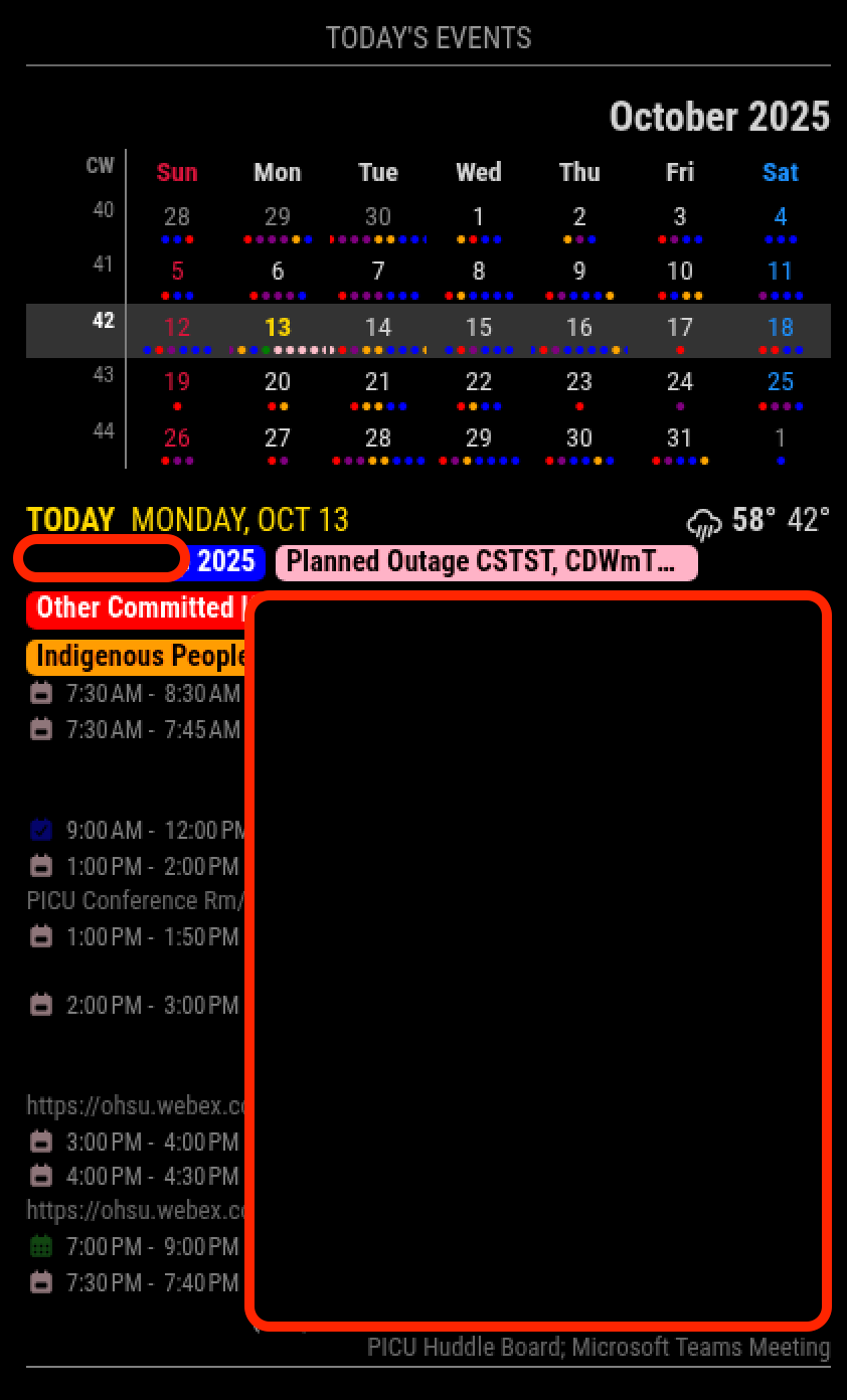

        Not a dumb question at all, that was the first thing I checked. I wish my life would go three days without an event. But I’ve tried setting endDayIndex to 10, eliminating the indexes completely, eliminating the calendarSet, stripping the entire module down to just the header, the position, the waitFetch and refreshInterval, and it’s still blank. The only way I know that there’s something happening is the header is still there. I tried commenting out the other modules and positioning CX3A top left to see if it was a graphics issue but it’s the same empty header. Yet when I fire up all the modules, CX3 weekly is still showing every event perfectly from the first fetch. I’m stumped. And then when I quit out, the terminal shows no issues, and lists all the events that are successfully being broadcasted by each calendar.
