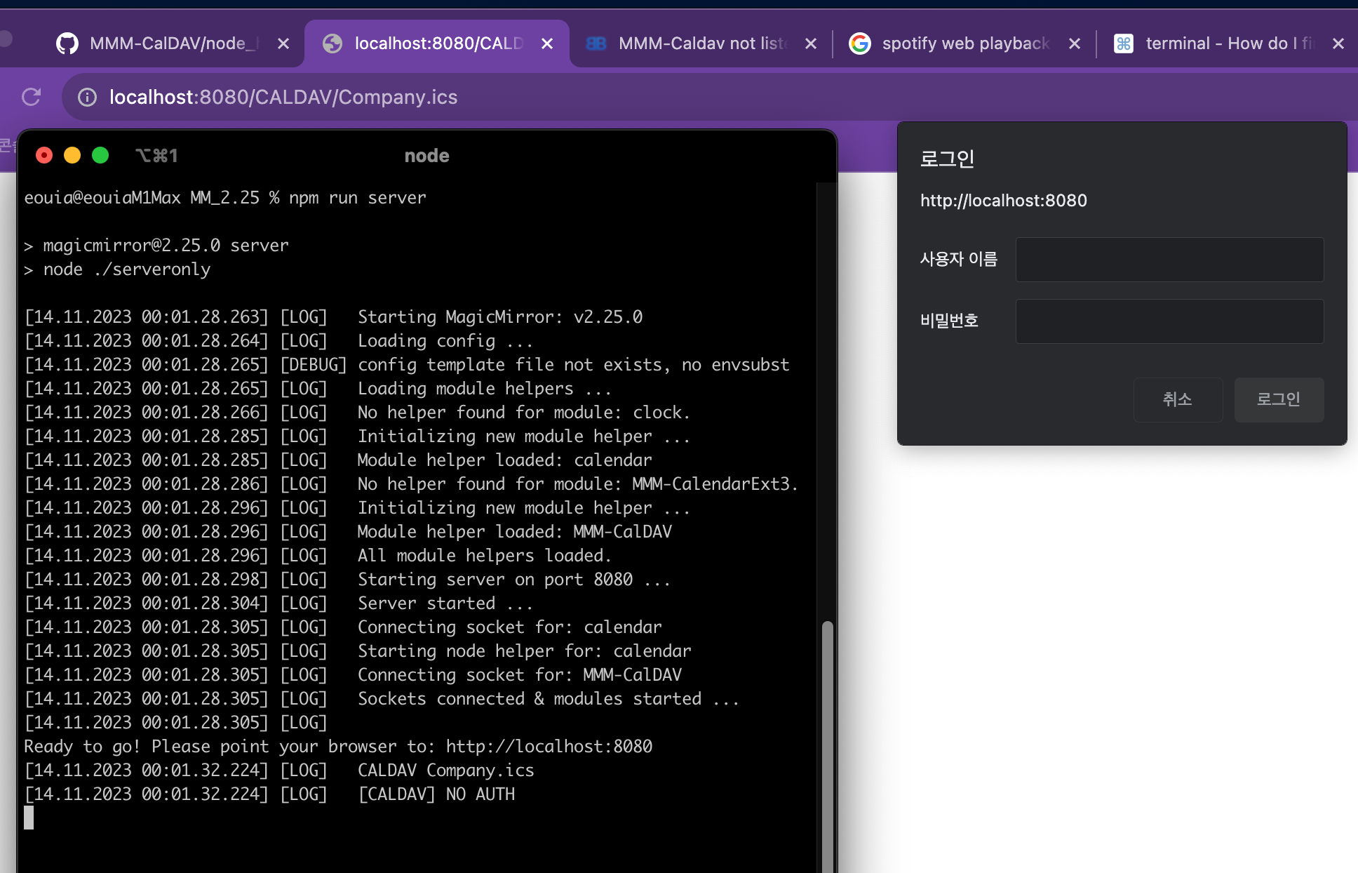

                This image shows that I tried serveronly mode, then try to access Company.ics which is not even fetched in this execution before any client is launched. (The iCal file was fetched in the previous execution)
                And showing it hit the access but failed due to no auth. (So that’s why the browser show auth dialog box)
                With curl (anyway, -v option is not enough to access this served ical. You should use -u option.) It should have 401 error withou auth info.
