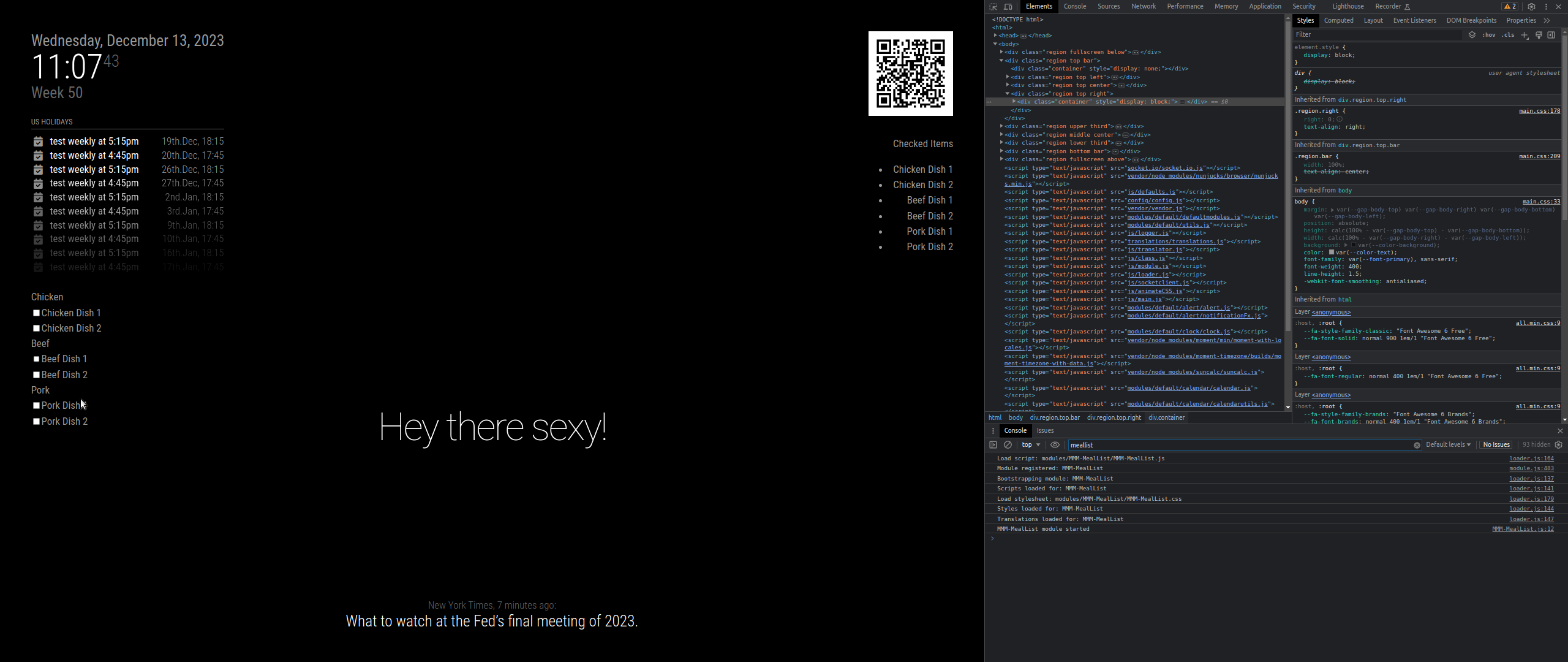

                  sdetweil
                  @DarkwingBuilds always fun!!.
                  now that you are working in the browser side, you can use the developers window debugger and step thru the code
                  ctrl-shift-i on the browser keyboard (you can use the PC browser if u enable mm config.js for outside system access)
                  select to sources tab
                  in the left nav, navigate to modules, your modules, select on the source file name
                  I cropped this just to show you where the debugger tools are and where you would click to add a stop
                  right pointing debugger tool arrow is run to next stop (if any)
                  circle with arrow is step one instruction
                  downward arrow is step into next routine, up arrow is step back out
                  and if you use the elements tab, you can see the browser view of your content

                      @DarkwingBuilds

                        @DarkwingBuilds both showing (checked needs to be looked at)
