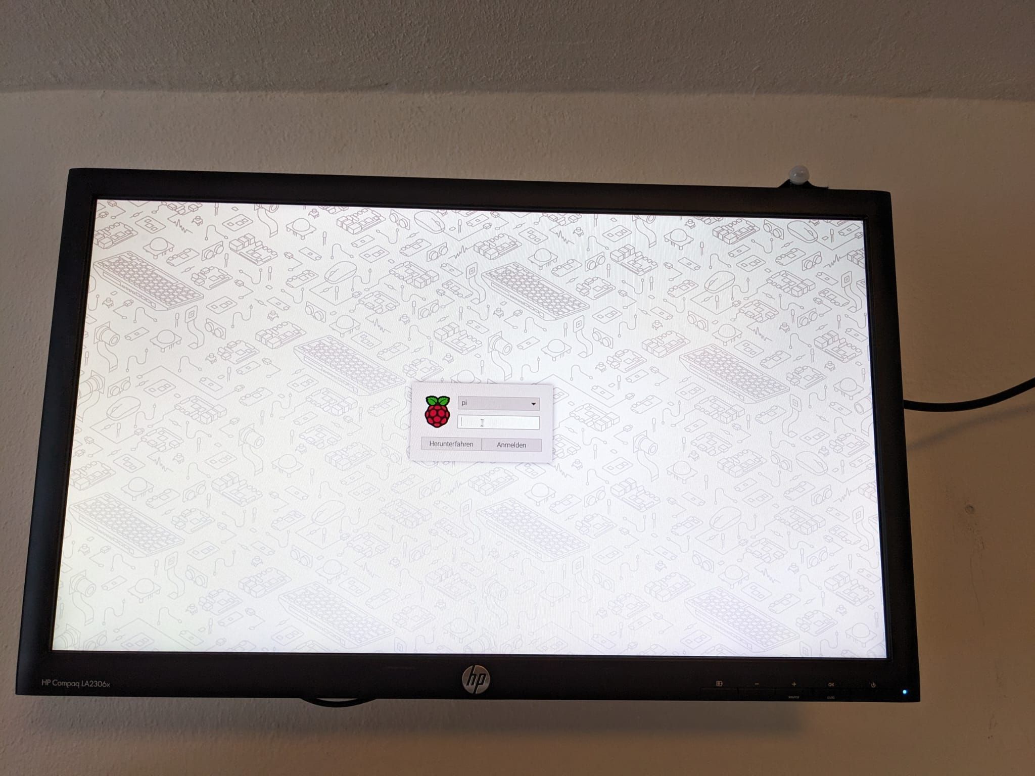

      i have an issue with my new Magic Mirror installation on Raspbian Bookworm on a RPi 4a (Wayland). I have configured it with “Screen blanking off” and automatic login, but after a while of 15-20 minutes the Screensaver screen comes up.
      I´d appreciate any idea.
      Thanks much and best regards,
      Raimund
        sdetweil @RayDoyle
        @RayDoyle did you use my script during install?
        if not you can run the screensaveroffscript
        see
        https://github.com/sdetweil/MagicMirror_scripts
        see down the page, copy/paste to execute
