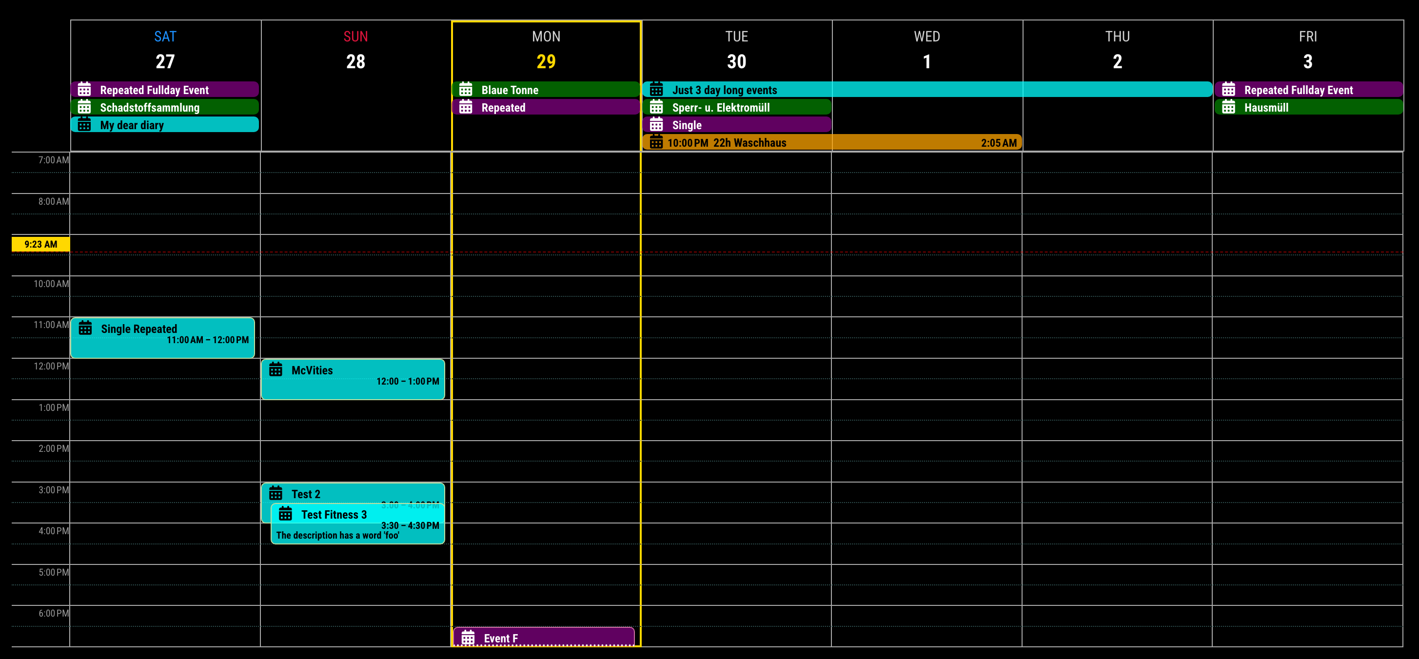

      I’ve got the Journal displaying properly and have been able to modify of few things in the CSS file, but something I have not been able to figure out is if I can put a noticeable white border around the complete day, similar to how you in CX3 with the line CX3 .cell.today. Is there a way to isolate the entire day’s column? I tired playing with the .daycell and .fulldayCell classes, but those did not work.
      Additionally, is there a way to figure out what some of the later classes are such as .canton, .index, and .gridCell.
        It is not supported. Well, at least not in a simple, easy way. But I’ll add that in the next update soon.
        canton means the top-left corner of the table. I’m not sure of the exact term in native English. :)
        index means hour-index(left edged) of the table.
        gridCell means the table’s rectangle grid (usually 30 minutes of the day).

              I updated CX3J to 1.0.1 to represent more detailed selectors. And by default, the border would be shown on today’s column.
