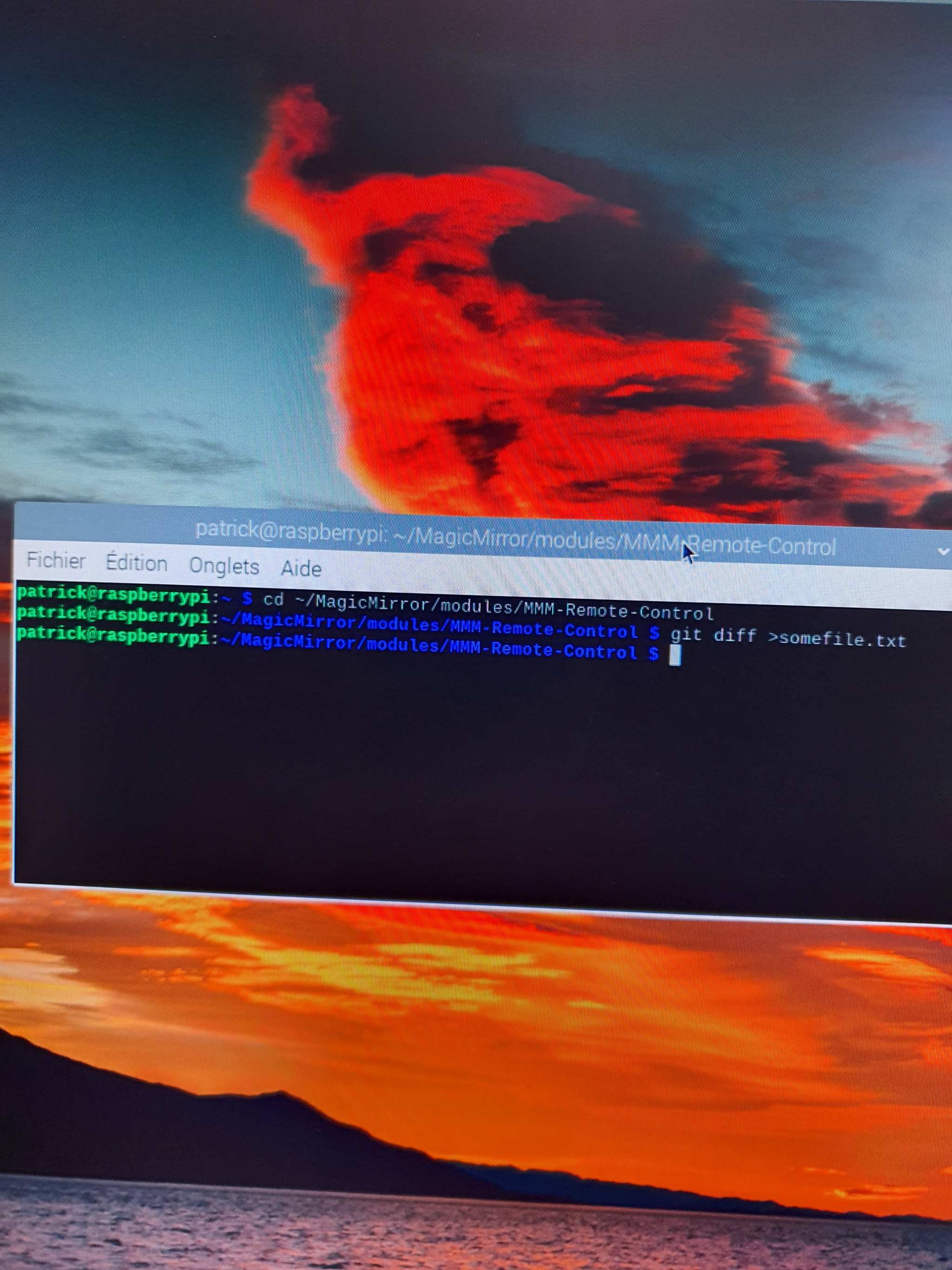

              • P Offline
                pat59
                nothing happens attached
                the photo
                THANKS
                  sdetweil @pat59
                  @pat59 yes, the output has been sent to the file somefile.txt
                  please paste its content here
                  in linux the ‘rule’ is, if all is ok, produce no output… this was set when systems were connected over slow phone lines with modems… so no output was better than waiting to read all was good.

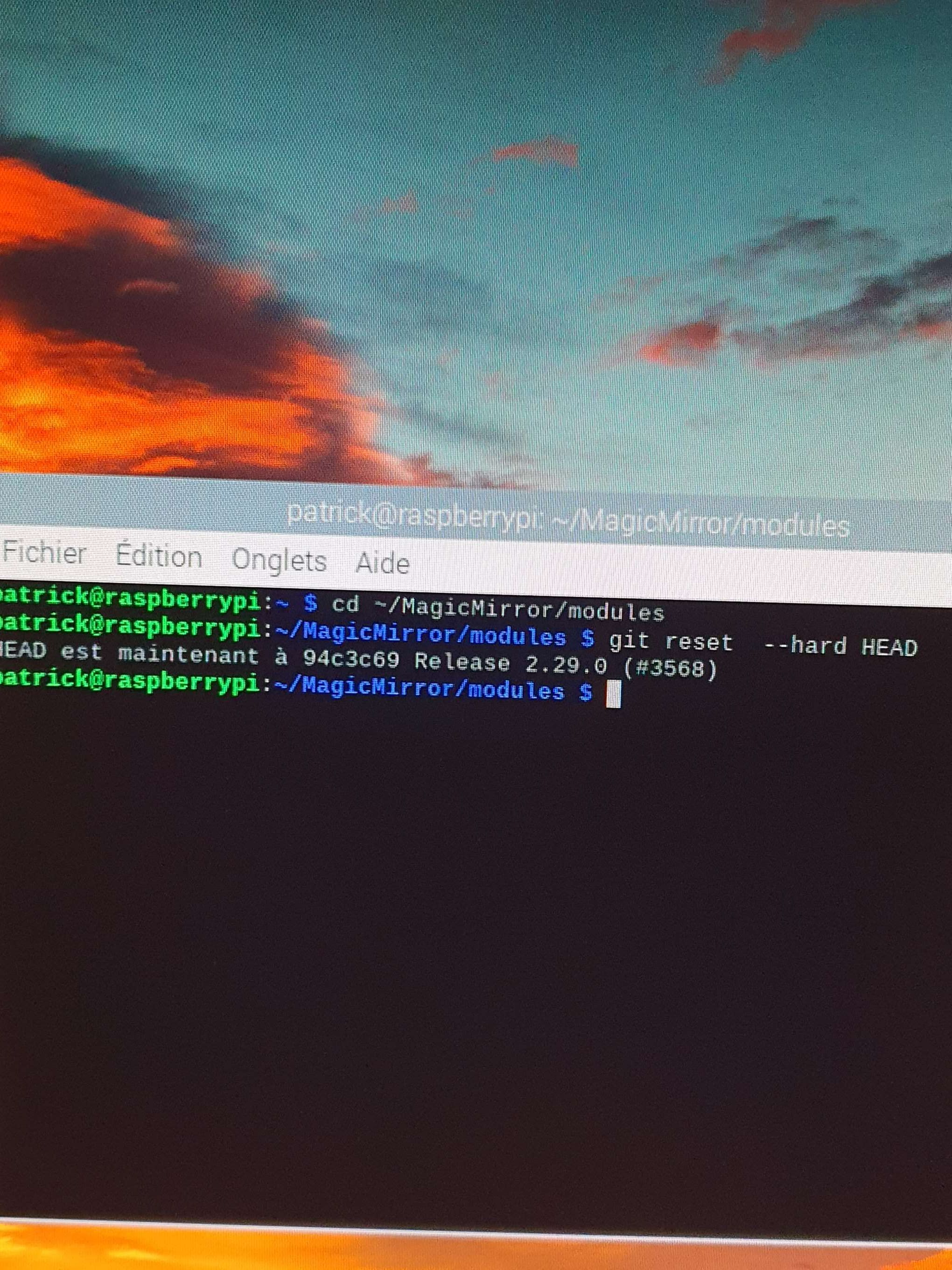

                            always the update message that appears
                            • P Offline
                              pat59
                                sdetweil @pat59
                                @pat59 no, in the folder of the module you are having trouble updating
                                MMM-RemoteControl
                                as you are having trouble with one module, all the commands would be relative to that module’s folder… right??
