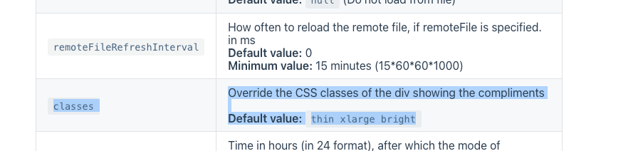

        sdetweil @raspberrypi9
        @raspberrypi9 which pinned post?
        the doc
        says there is a classes config property
           module: "compliments",
           position:"....",
           config:{
               classes:"thin xlarge bright",   // default if not specified
        so, you could override one of those
        .compliments .xlarge {
             color: xxxxx;
        or you could add another classname and configure that
           position:"....",
           config:{
               classes:"thin xlarge bright foo",   // default if not specified, this replaces entire list
        like this
        .compliments .foo {
             color: xxxxx;
          raspberrypi9
          That worked great! Thank you so much for taking the time to answer my question.
