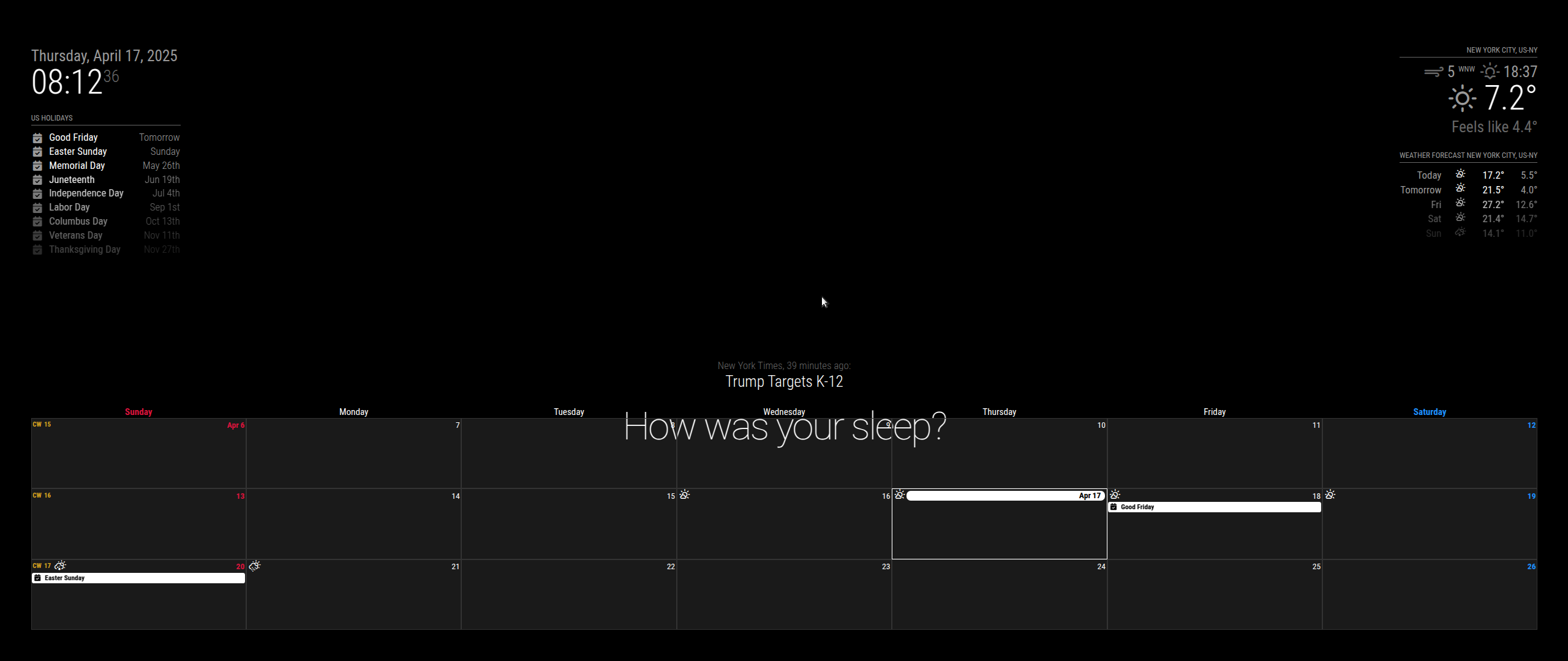

              sdetweil @Kayos
              @Kayos I just added Ext3 to the copy of the sample config .js and got this
              this is the end of my config.js
                                              module: "MMM-CalendarExt3",
                                                position: "bottom_bar",
              the default Ext3 config is ‘week’ mode , with 3 weeks in view

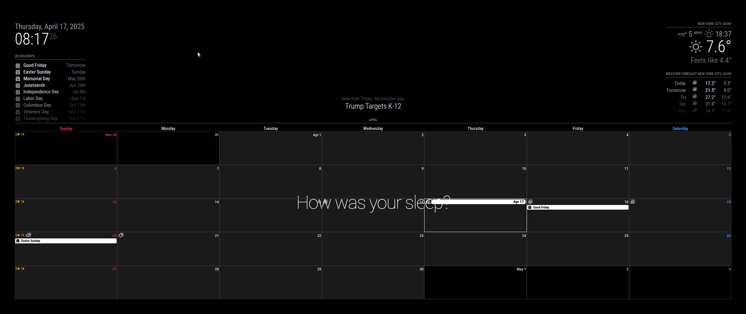

              and got this
              config.js now ends
                                                 mode:"month"
