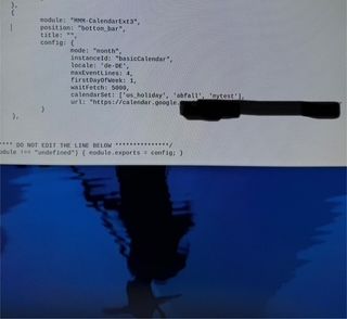

      I am still having trouble getting my google calendar to show anything on my calendar. I am also not sure why part of my calendar is in two different languages. See my config. Any help would be great thanks.

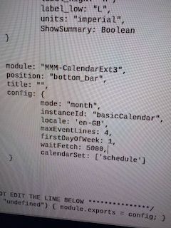

            I was able to get my calendar working. I like how it shows it up in the top corner what I have coming up, but its still not showing anything on my actual calendar.
            module: “MMM-CalendarExt3”,
            position: “bottom_bar”,
            title: “”,
            mode: “month”,
            instanceId: “basicCalendar”,
            locale: ‘en-GB’,
            maxEventLines: 4,
            firstDayOfWeek: 1,
            waitFetch: 5000,
            calendarSet: [‘schedule’],
            url: “https://calendar.google.c”
            Let me know if you see something I have wrong.
              sdetweil @tink8909
              @tink8909 again, url does not go in this module,
              it goes in calendar module
              calendar module gets events from calendar source (google),
              and then broadcasts them out to other modules to use
              so only one module reads from source
              ext3 uses the broadcast
                @tink8909 use the default ext3 config from the readme file
                then customize

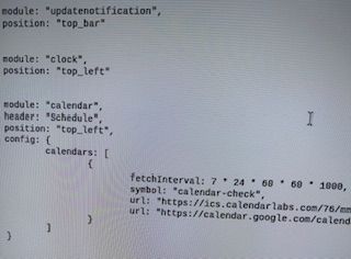

                  This is both configs from the calendarext3 and the default calendar.IMG_6096.jpg IMG_6095.jpg
                    sdetweil @tink8909
                    @tink8909 you have 2 urls in the default calendar, block
                    it should be like this
                    calendars:[
                            url:"..."
                            url:"...."
                    the way you have it the second url overwrites the first, as there can only be one inside the {}

                        sdetweil @tink8909
                        @tink8909 in the ext3 config remove calendarSet, as you didn’t name the calendar
                        again, i STRONGLY recommend start by using the minimal ext3 config
                            module:"MMM-CalendarExt3",
                             position:"bottom_bar"
                        then you can add the config:{} block
                        change mode to month
                        change 1 parm at a time
                          @tink8909 also the default cal refresh rate is once per week,
                          and ext3 is probably waiting for next broadcast if it missed the first
