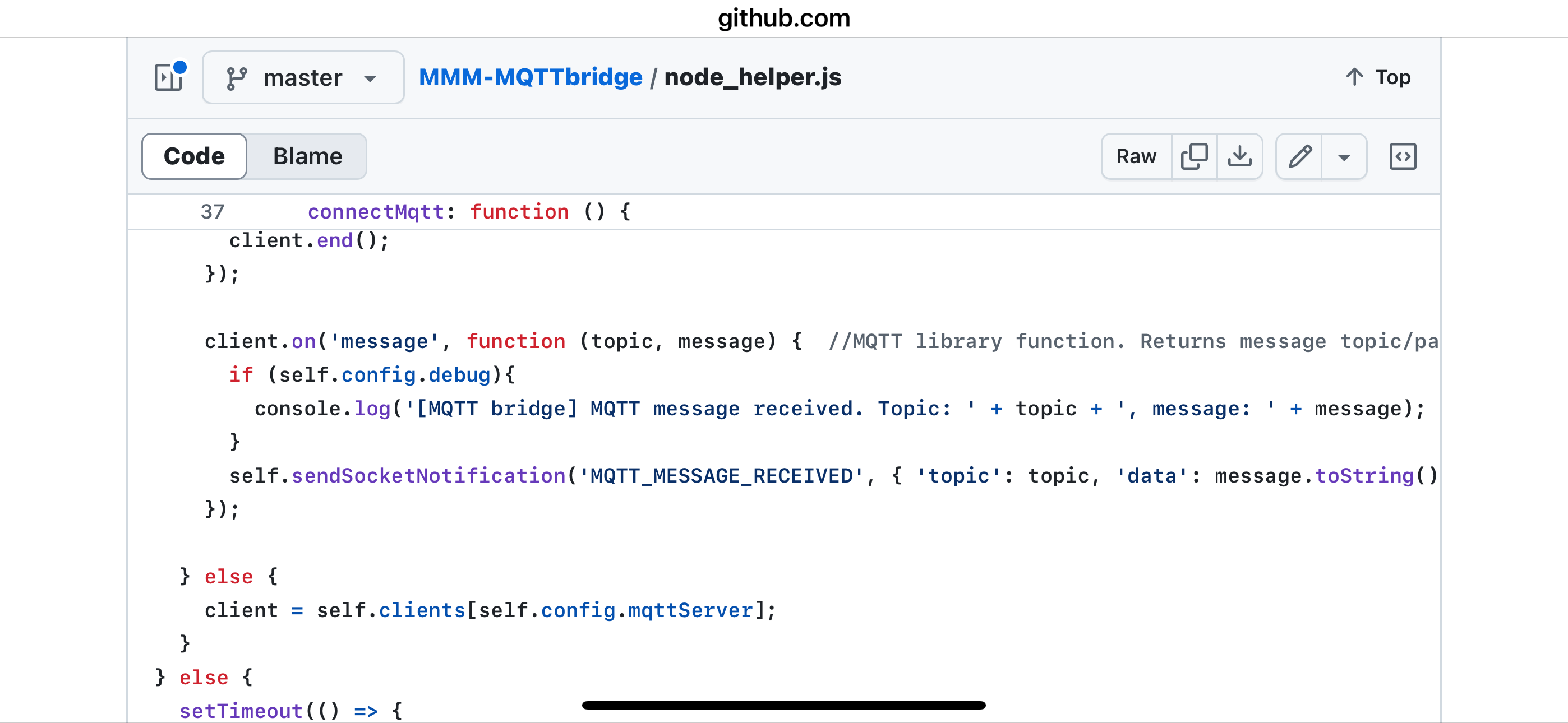

                      @Cr4z33 looking further at mqttbridge it also logs receipt of the notification from the subscription
                      so that tells me it did not receive info from mqtt

                          sdetweil @Cr4z33
                          @Cr4z33 im saying the module will report when it receives the mqtt info. it did not report. sooooo it did not receive the info
                          why i do not know

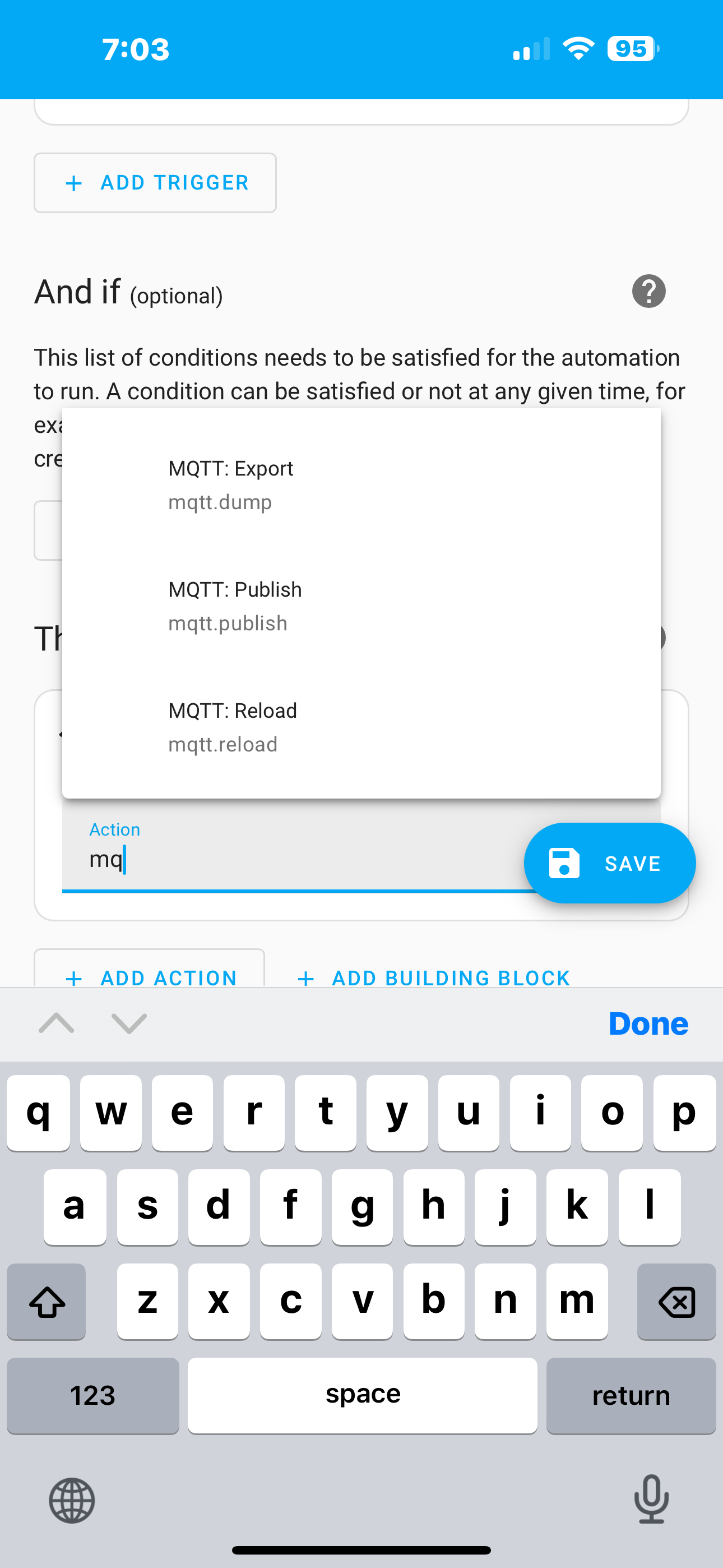

                              sdetweil @Cr4z33
                              @Cr4z33 i dont know, but MQTTBridge was not informed of the button press as you expected
                              is your other bridge code running? you mentioned you had some app talking to the doorbell and publishing the mqtt message
                              is the doorbell an mqtt device , fed thru zigbee2mqtt for homeassistant?
                              or is there a native integration?
                              i would expect the doorbell to NOT publish to mqtt directly
                              it would be a tiny market to add and support that code IN the doorbell firmware
                                @Cr4z33 you could build an HA automation to send the MQTT message on button push
                                Cr4z33C 1 Reply Last reply Reply Quote 0

                                    sdetweil @Cr4z33
                                    @Cr4z33 something is not sending the mqtt message
                                    bell -> ha automation -> mqtt -> mqttbridge -> rtsp…
                                    should work
                                    for me, this works
                                    alexa-> nodered -> mqtt > ha automation -> mqtt -> mirror_app -> screen off

                                            sdetweil @Cr4z33
                                            @Cr4z33 and the ring module talks directly to the ring doorbell
                                            you should be able to use HA automation to get to mqttBridge, no fancy coding
                                            automation trigger
                                            device bell button push
                                            action, more, command, mqtt publish
                                            i have ring doorbell, and the module doesnt work for me
                                            doesnt matter, as im hardly ever in front of the smartmirror when the doorbell rings
                                            there is a ring2mqtt docker container, but again it really doesnt add anything useful
