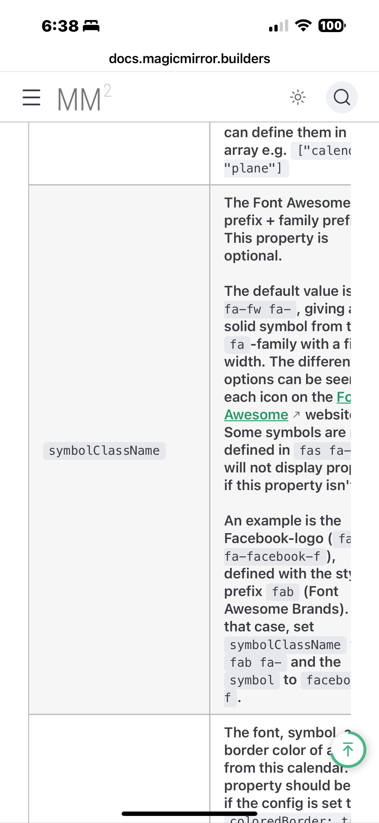

                    sdetweil @rkorell
                    @rkorell you download the collection into the fonts folder
                    then the icons have a prefix
                    in calendar see the symbolclass and symbol values of the calendar definition ( includes the url:…)
                    https://docs.magicmirror.builders/modules/calendar.html#configuration-options
                    R 1 Reply Last reply Reply Quote 1
