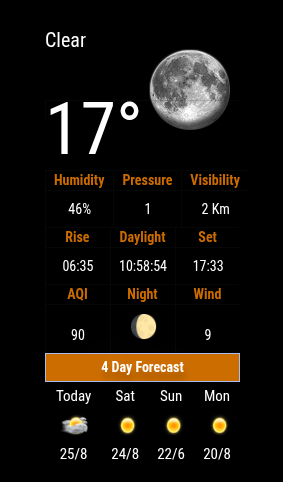

            @Freddy_boy Just out of interest, why use multiple instances for current and forecast if you can get both in a single module? There are a few different modules that provide the combined view.
            My apologies, just want to know out of interest.
            Below is an example of both rolled into one.

              Freddy_boy @mumblebaj
              @mumblebaj
              Wow! That looks like just what I would need… What module is that? I thought that sticking to the default modules would be advantageous but maybe that is a better solution.
              mumblebajM 1 Reply Last reply Reply Quote 0

                mumblebaj Module Developer @Freddy_boy
                @Freddy_boy You can have a look at the following link.
                NOAA3
                This is my forked version which works and caters for different providers.
                  @mumblebaj
                  I installed the module and it looks good! I will continue to monitor for the next while to see if the updates continue to work. Thanks!
