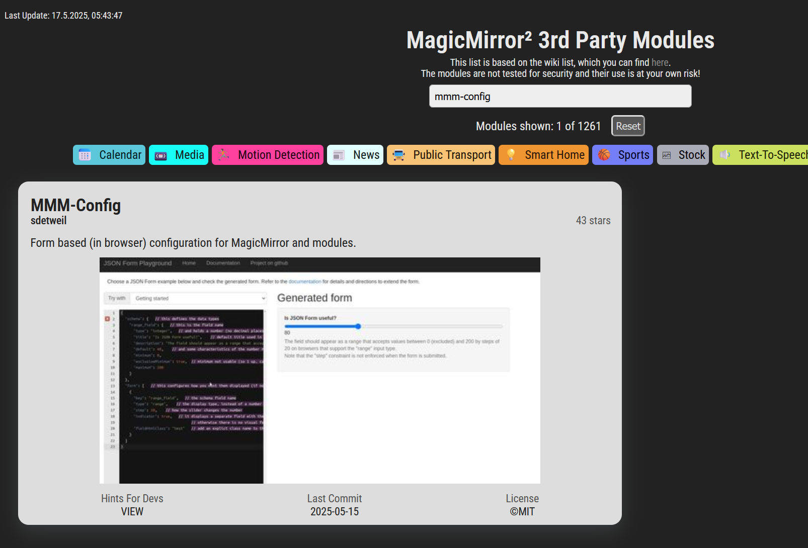

                      sdetweil @karsten13
                      @karsten13 my screenshot is not displayed and dev advice page will not open
                      MMM-Config
                      license reporting is correct
                      seems all dev view is broken
                      took 45 seconds to open on my phone on wifi on 1g network.
                      karsten13K 1 Reply Last reply Reply Quote 0

                        • KristjanESPERANTOK Offline
                          KristjanESPERANTO Module Developer
                          @sdetweil said in LICENSE: on modules.magicmirror.builders shows @noassertion instead of MIT:
                          that is the wrong screen image…
                          How the image is selected is documented here:
                          https://github.com/MagicMirrorOrg/MagicMirror-3rd-Party-Modules#how-do-i-get-my-module-presented-perfectly-in-the-new-list
                          • karsten13K Online
