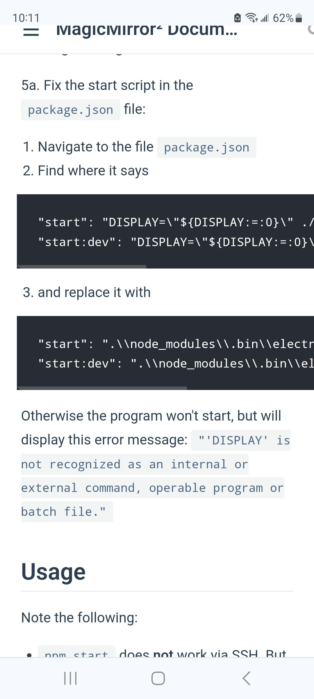

              Currently working through install and received an error regarding my display - searched and found this from a forum but I cannot find the document with the full line of code - I believe you may have been one to respond to the post:
              Do you know where this documentation may be? I looked at install docs and couldn’t find it…
              Thank you!
                sdetweil @dmykins

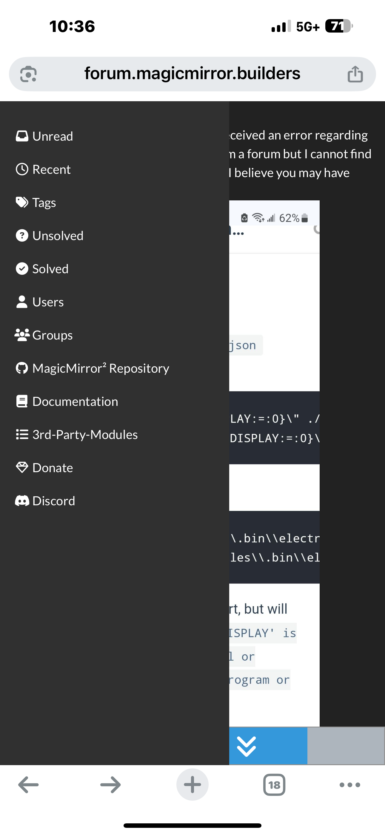

                @dmykins all our doc is linked in the forum header, you are looking at old stuff
                https://docs.magicmirror.builders/getting-started/installation.html#other-operating-systems
                  sdetweil @dmykins
                  @dmykins the forum menu

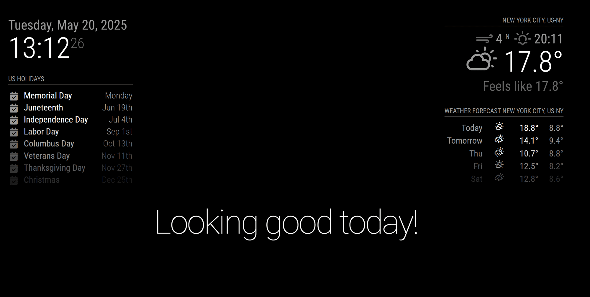

                    Looks like I have it up and running on my PC:
                    Just need to work through installing modules.
