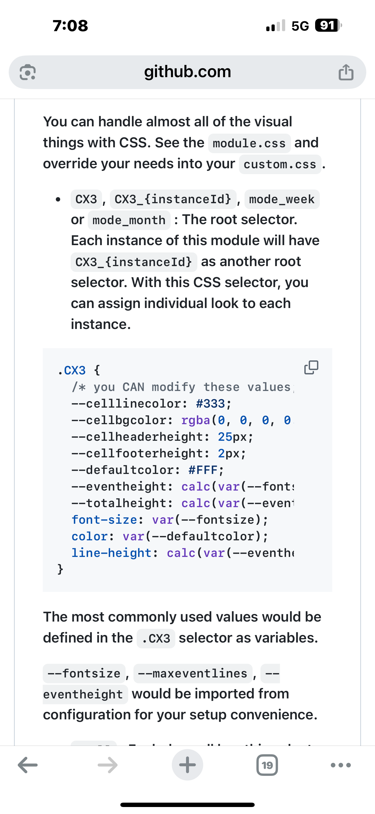

                    Thanks Sam. Is it possible to scale the heights of cells in a month view? This way all months will be scaled based on the maximum of 6 rows. If so, how? Thanks.
                      sdetweil @sankum
                      @sankum see the module readme, for all kinds of settings
                        @sankum so using eventHeight and maxEventLines in the module config will set the week row height
                        No css required
