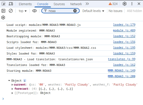

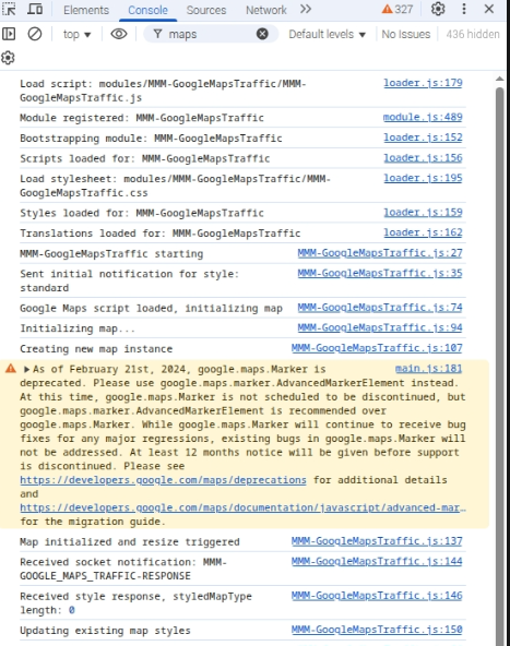

        can you
        open the developers window , ctrl-shift-i,
        and select the console tab
        enter a unique part of the module name in the filter field
        maps
        or
        noaa
        and see if there are any errors reported.
        for NOAA3 did you see the note about updates
        https://github.com/cowboysdude/MMM-NOAA3, issues heading

          @sdetweil thanks for such a quick reply,
          here is what I am see.
          the map one was a lot longer but seemed like simular to the noaa one, except for this spot 95db5112-55a9-4f6a-aad6-279abbdcde96-image.png
          S C 2 Replies Last reply Reply Quote 0
            sdetweil @Eagleyes27
            @Eagleyes27 googlemaps traffic default update rate is 15 minutes
            noaa3 is 30 minutes
              so show 30 minutes later
              • C Offline
                chrisfr1976 @Eagleyes27
                @Eagleyes27
                The message from google maps can be ignored currently. There is a plan to change the marker but currently the old AND EASY way is still working. I have a new version already ready but to get the new marker running is really complicated. So I didn’t update the module to this until now.
                I care about the module now. Is works good on my side. If you discover any general issues I can fix it. But this is important: do you run my fork?: https://github.com/ChrisF1976/MMM-GoogleMapsTraffic
