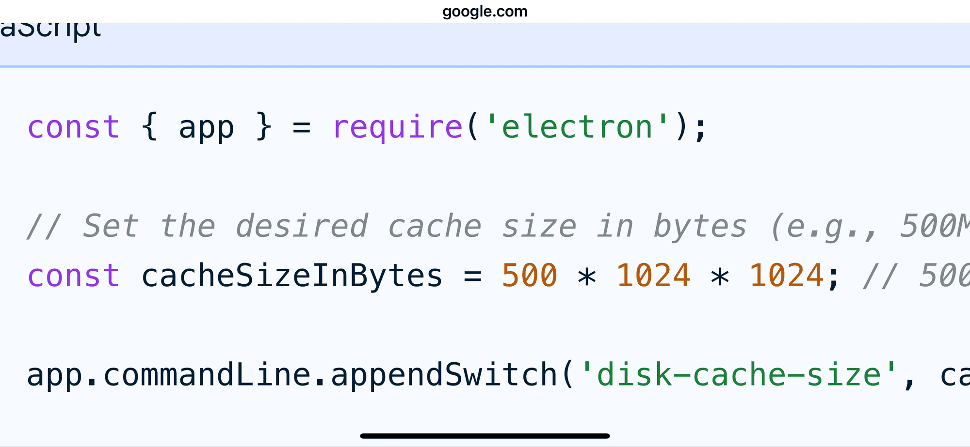

        sdetweil @Nneuland
        @Nneuland
        You can increase the cache size
        In config.js
        I am in car, will find in code
        Above the modukes:[] list
        electronSwitches : {. Switch_name:value, … },
          sdetweil @Nneuland
          @Nneuland note I updated the prior post

            @sdetweil Thank you for the reply Sam.
            This change is happening in MagicMirror/js/electron.js, or config.js?
            I appreciate your time.
            -Nick
              sdetweil @Nneuland
              @Nneuland config.js,
              ALL config goes in config.js
              Always
              N 1 Reply Last reply Reply Quote 0
              • N Offline
                Nneuland @sdetweil
                Would you be able to share the full code? Even a snippet of config so it’s more clear where the full cache code is? I don’t see any documentation on this.
                -N
                  sdetweil @Nneuland
                  @Nneuland I posted the property model and the switch name
                  I think you can cut/paste
                  I don’t know what cache value is helpful
