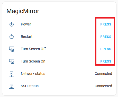

            Using this integration, any SSH command can be turned into button like so :

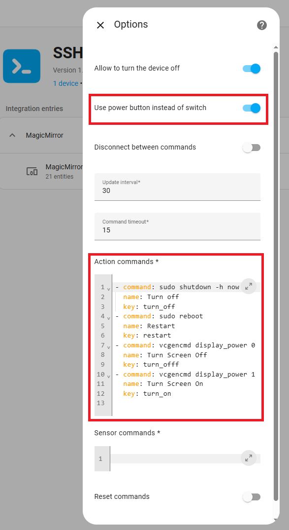

            If you’re using a Pi, you can use the following in the configuration options of the integration :
            The actual code for your ease of use :
            - command: sudo shutdown -h now
              key: turn_off
            - command: sudo reboot
              key: restart
            - command: vcgencmd display_power 0
              name: Turn Screen Off
              key: turn_offf
            - command: vcgencmd display_power 1
              name: Turn Screen On
              key: turn_on

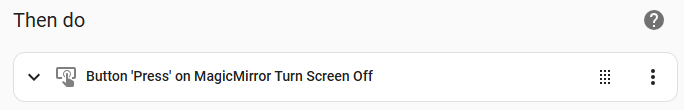

            This results in a bunch of buttons that you can use in your Home Assistant automations
