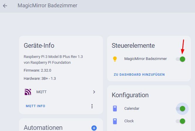

      K
      Klinge
    • Switching the Magic Mirror display on/off
      I want to automate my MMMs via Home Assistant.
      To do this, I installed the MMM-Home-Assistant module on my MM. The MMM is now also recognised as a device in Home Assistant (HA).
      There is a control element called ‘Magic Mirror Bathroom’. I can use the button to switch the monitor display on and off.
      But now I have the following problem.
      When I press the button while the MM is running, the button first moves from right to left (i.e. from on to off) and the display is switched off. Just as it should be. But after about 2 seconds, the button moves back from left to right (from off to on). However, the display remains switched off.
      If I want to turn the display back on, I have to press the button, which is now on the right (i.e. on), again so that it moves back to the left (off). Then, within the 2 seconds that the button is on the left (off), I have to press it again so that the button moves back to the right (on). Then the display turns back on.
