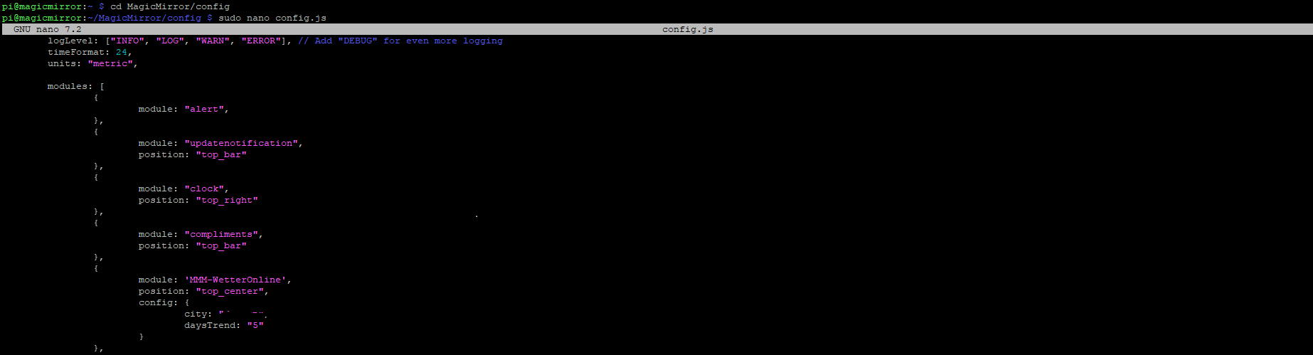

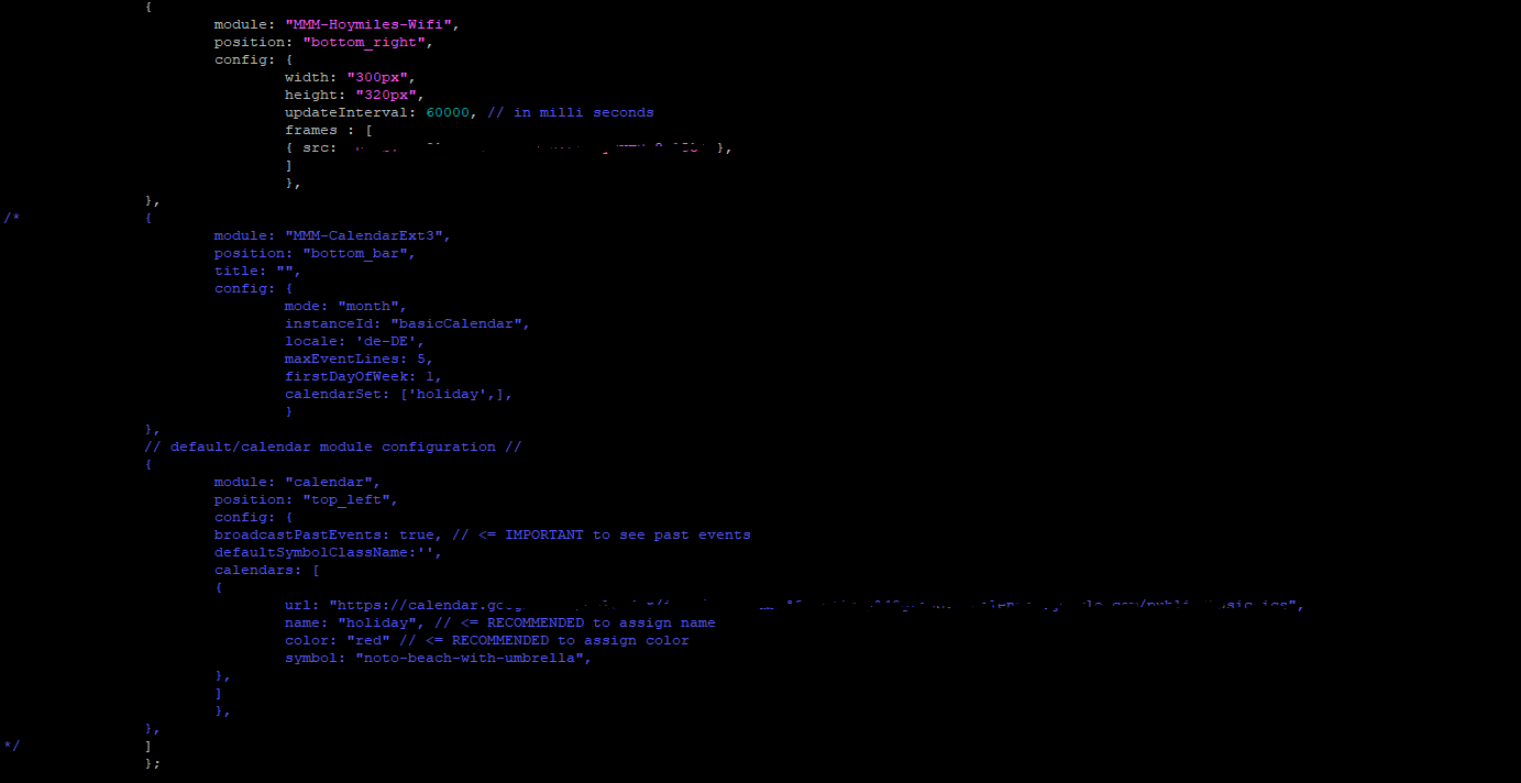

      Hello everyone,
      I am experiencing an issue where my mm is no longer displayed. I am unable to identify the error at this time. I would appreciate another pair of eyes to take a look at it.
        sdetweil @Periz
        @Periz you cannot have the SAME port being used by multiple apps
        you have 3 instances running, probably ALL trying to use port:8080
        (as defined in config.js, a few lines above what you displayed)
        so,
        pm2 logs --lines=100
        then
        pm2 stop all
        then
        # clear logs
        pm2 flush
        pm2 start 0
        also you can check the config from the commandline
        cd ~/MagicMirror
        npm run config:check
