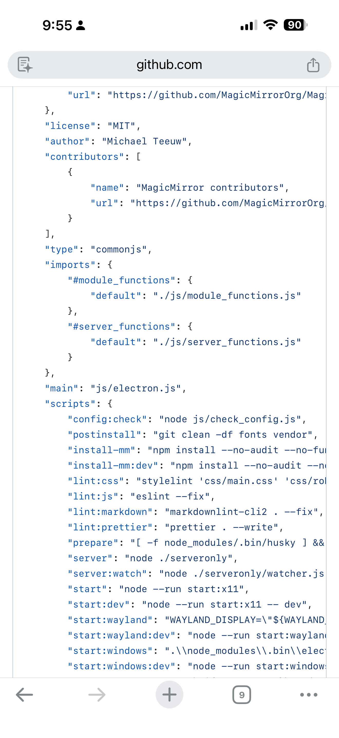

                    @MagicPi:~/MagicMirror $ tail --lines=200 package.json
                    	"name": "magicmirror",
                    	"version": "2.34.0",
                    	"description": "The open source modular smart mirror platform.",
                    	"keywords": [
                    		"magic mirror",
                    		"magicmirror",
                    		"smart mirror",
                    		"mirror UI",
                    		"modular"
                    	"homepage": "https://magicmirror.builders",
                    	"bugs": {
                    		"url": "https://github.com/MagicMirrorOrg/MagicMirror/issues"
                    	"repository": {
                    		"type": "git",
                    		"url": "https://github.com/MagicMirrorOrg/MagicMirror"
                    	"license": "MIT",
                    	"author": "Michael Teeuw",
                    	"contributors": [
                    			"name": "MagicMirror contributors",
                    			"url": "https://github.com/MagicMirrorOrg/MagicMirror/graphs/contributors"
                    	"type": "commonjs",
                    	"imports": {
                    		"#module_functions": {
                    			"default": "./js/module_functions.js"
                    		"#server_functions": {
                    			"default": "./js/server_functions.js"
