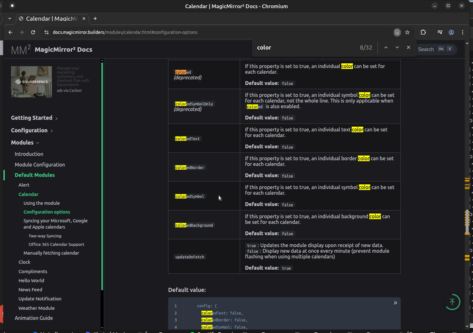

        sdetweil @ken.saut
        @ken.saut said in Not all events have a background color:
        there are parameters that turn on color between those two Screenshot at 2025-10-09 16-51-50.png

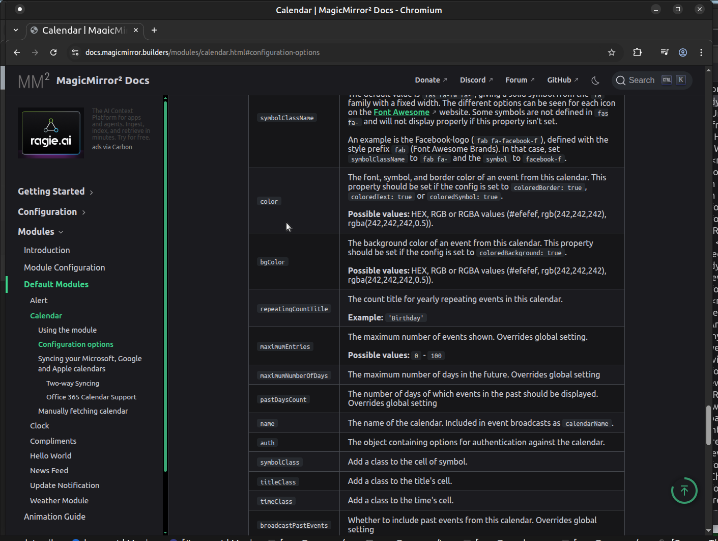

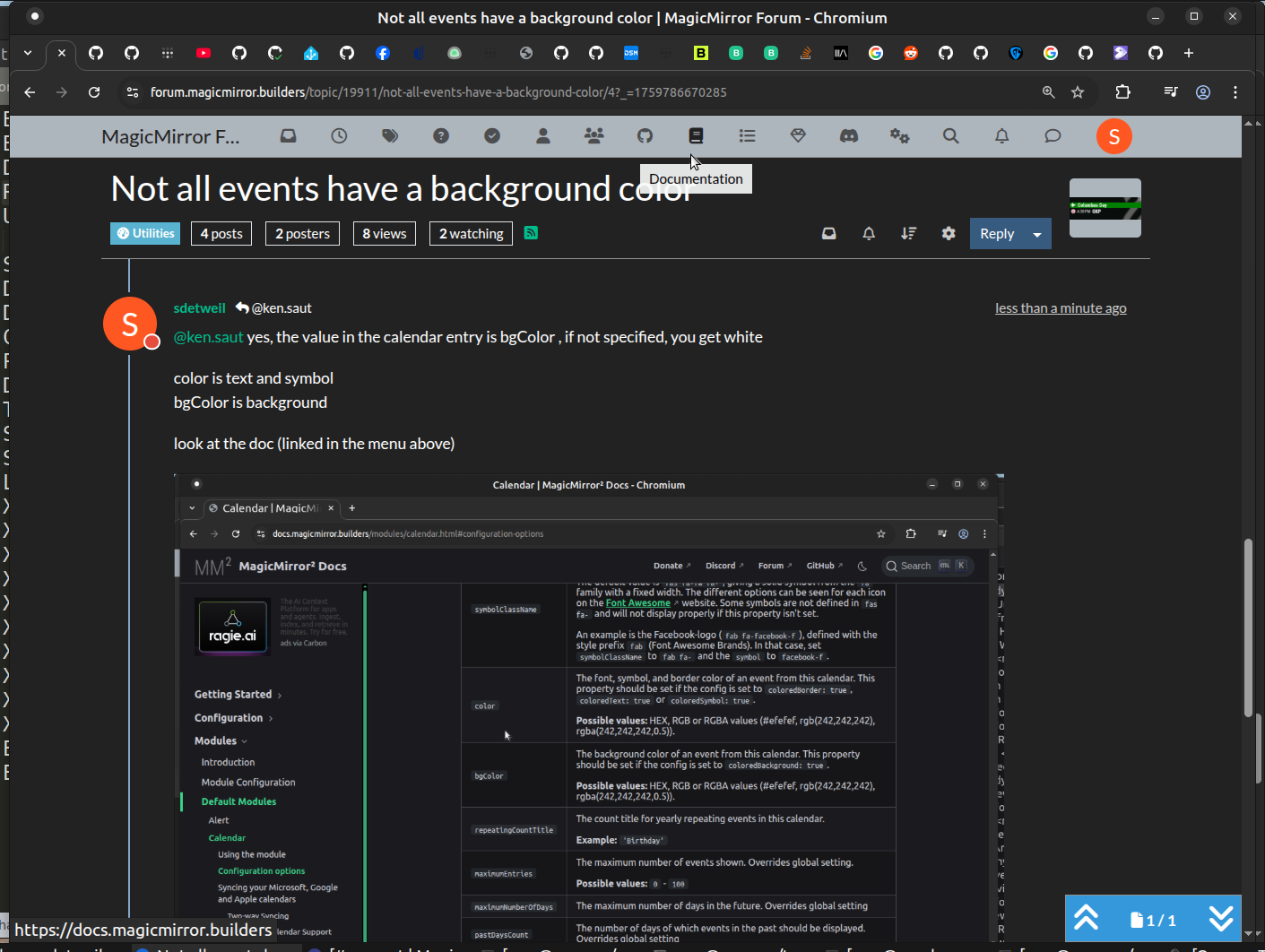

            sdetweil @ken.saut
            @ken.saut yes, the value in the calendar entry is bgColor , if not specified, you get white
            color is text and symbol
            bgColor is background
            look at the doc (linked in the menu above)
            doc in menu
