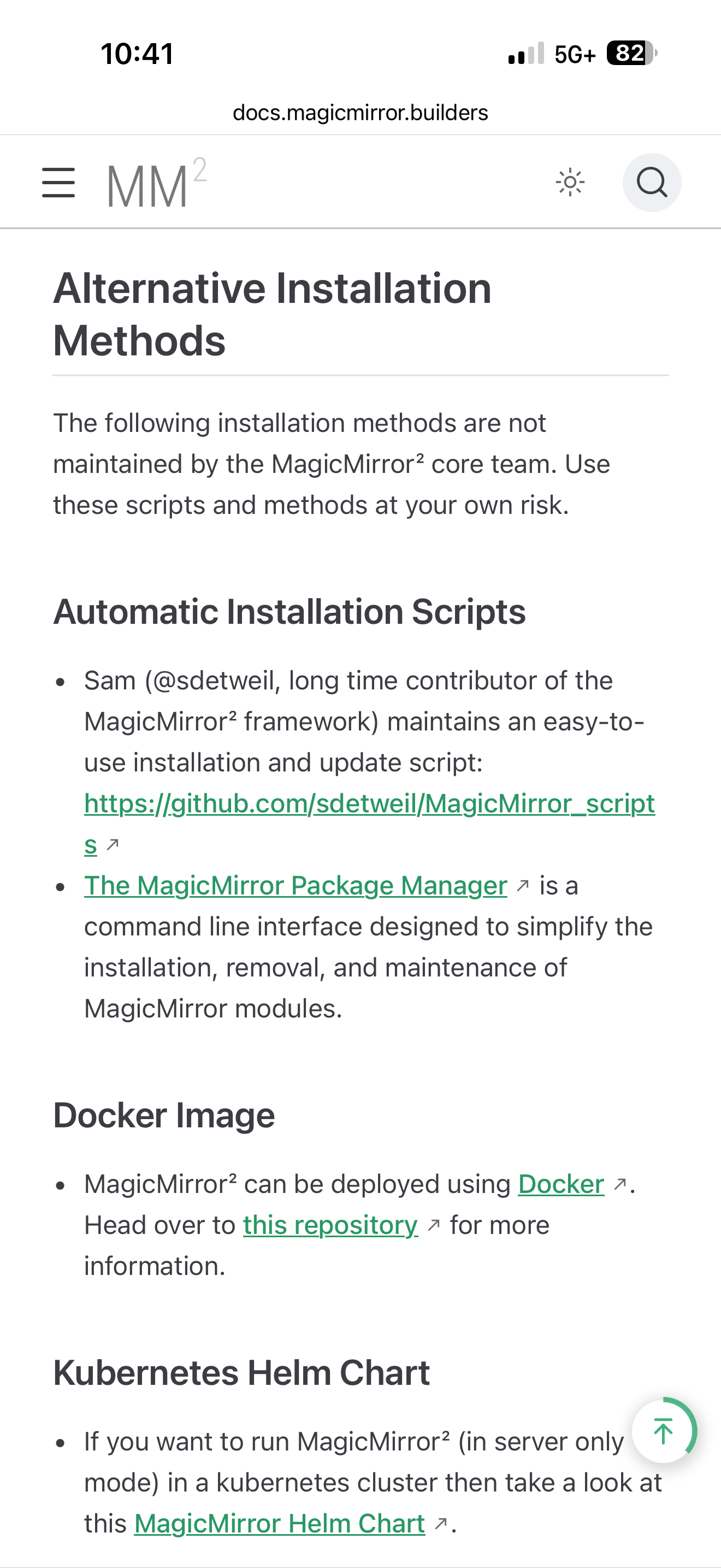

            sdetweil @sTo0z
            @sTo0z and w apikey 3. Now lat/lon are required
            As for script (they are mine) from the doc

                Ah I see, upgrade scripts. I’ll keep that in mind for next time :) Thank you! I do at the moment have MM in general loading and all my other modules are fine.
