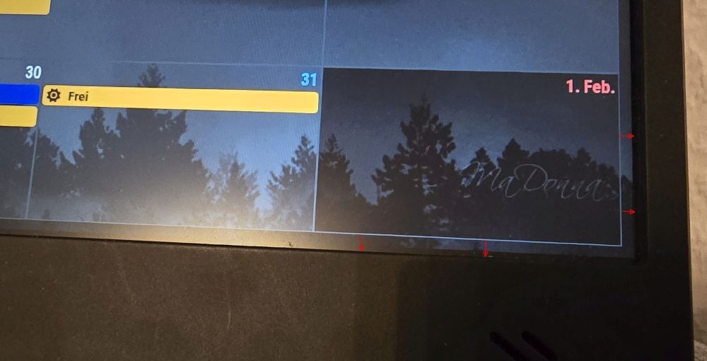

      Hello,
      How can I reduce the distance between the module,
      in this case MMM-CalendarExt3 view week,
      and the edge of the screen? See photo.

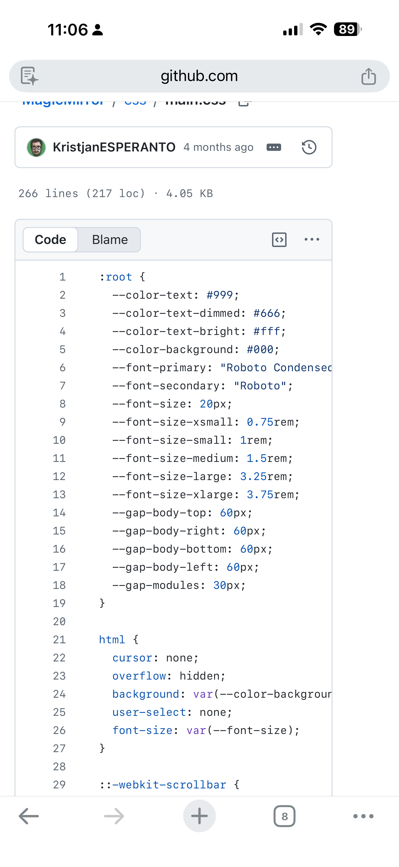

        sdetweil @Racing88
        @Racing88 MagicMirror has a border spacing/ margin
        See main.css and set a new value in custom.css
          Racing88 @sdetweil
          @sdetweil I found the solution. See photo.
          custom.css
          :root {
          –gap-body-top: 10px;
          –gap-body-right: 10px;
          –gap-body-bottom: 10px;
          –gap-body-left: 10px;
