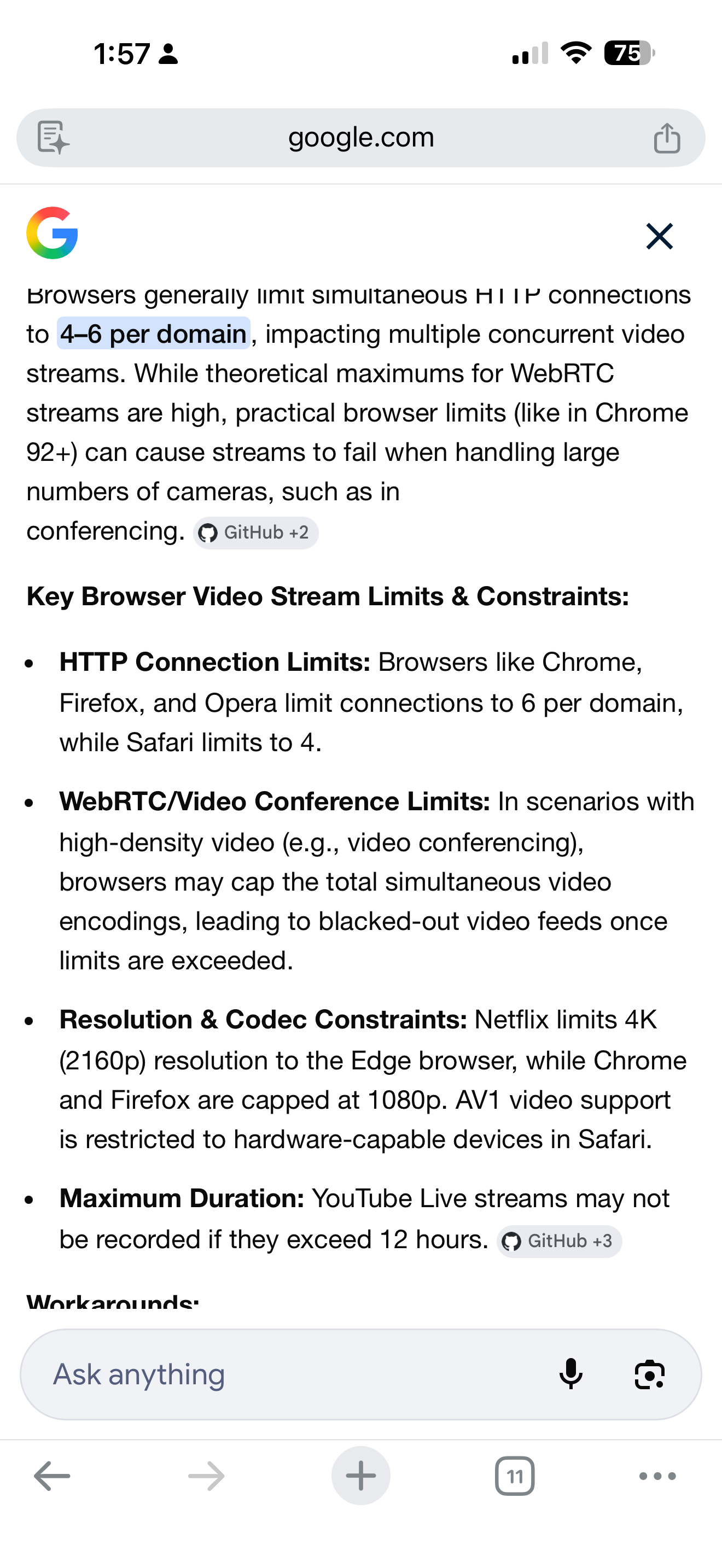

        @costascontis seems to be a browser limit, 6 per url hostname/domain

                @sdetweil tnhx mate this was very helpfull
