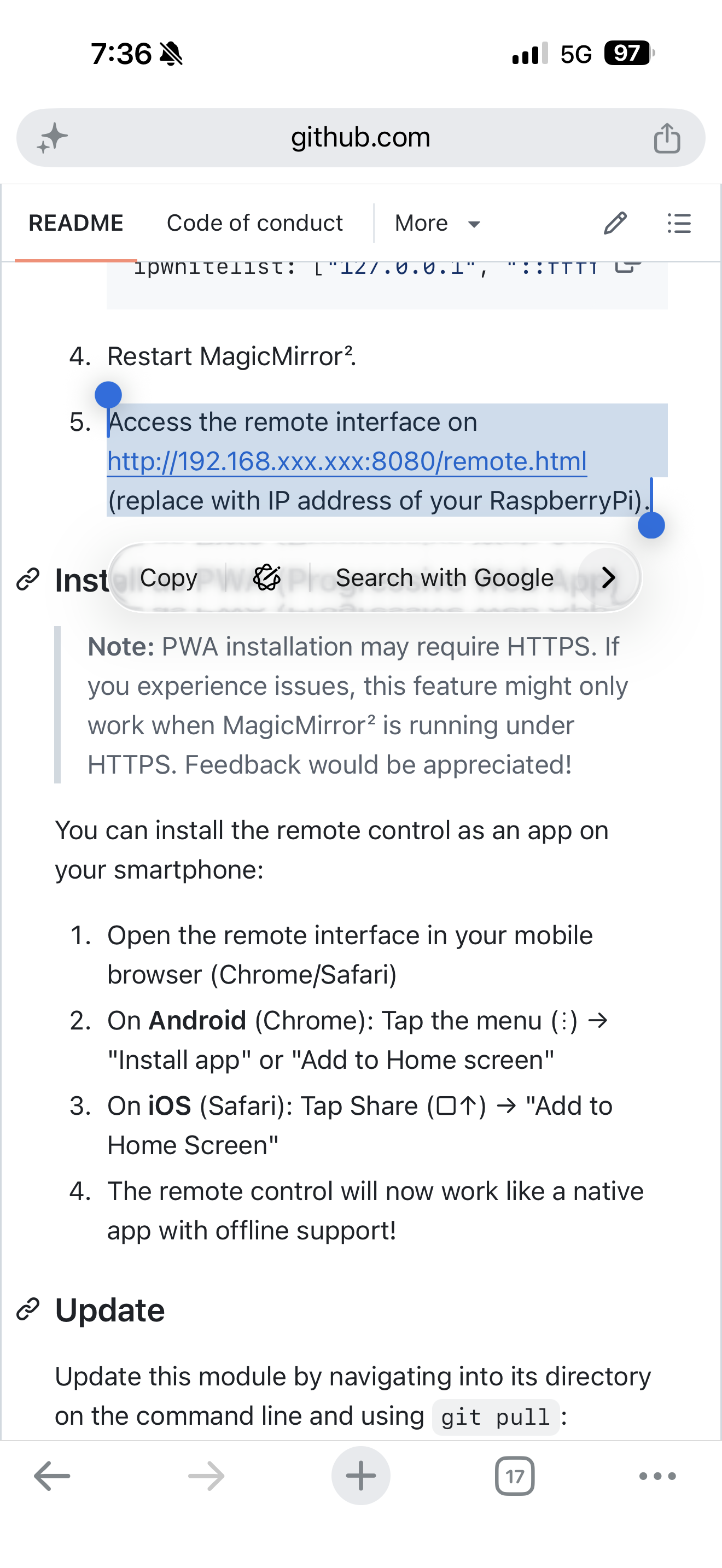

            sdetweil @tommyk
            @tommyk the app on phone says syntax error?
            can you open the app on a computer web browser so we can examine the browser logs?
            once loaded(or not) open the developers window, console
            ctrl-shift-i, then select the console tab, maybe the javascript error is listed there
            T 1 Reply Last reply

                        sdetweil @tommyk
                        @tommyk I installed RC, and used the default config…
                        then started mm and used my MM address and port, from the same machine
                        http://localhost:8090/remote.html
                        and from my phone
                        http://sams:8090/remote.html
                        both worked find
                        you DO have address and ipWhitelist set as “0.0.0.0”, and [], respectively, correct…
                        this allows any host (phone, laptop,… system other than MM machine) to connect to the MM server
                        otherwise the connection will be refused/blocked

                            sdetweil @tommyk
                            @tommyk mm is meant to be a closed system on the wall…
                            no one needs to access this, as its output only… SO
                            the default config says ONLY apps INSIDE this SAME machine can access the MM server
                            localhost is the name of the network connection (loop back)
                            now, it so happens one could add controls to limit JUST ONE (or a few) machines too…
                            this is the ipWhitelist
                            but as we’ve seen that (output only with no external access) doesn’t work for a number of use cases.
                            remote control, my mmm-config, …
                            SO, changing the config
                            address means listen for incoming requests on A network adapter, wifi OR ethernet…
                            address=“192.168.2.106” (for my desktop ethernet address)
                            but what if you have both? or more than one…
                            you can ONLY put ONE address there…
                            so there is a shortcut , “0.0.0.0”, means listen on ALL adapters, regardless their address…
                            now… i’ll just make an example, not implying anything…
                            you built this thing, and if ANYONE in your house could get in and fiddle with the MM parts, or others,
                            they might take the system down or something else…
                            kids that don’t know, but LOVE to explore…!!
                            how can i keep THEM out…
                            we I could limit access to ONLY MY phone, laptop,… then they couldn’t get in…
                            so you could put your phone and laptop ip addresses in the ipWhitelist:[] list
                            and then only YOU can get into the MM app system …
                            the RemoteControl readme, mentions this change in the config…

                                    sdetweil @tommyk
                                    @tommyk ok, I just added the QR to mine,
                                    what is the address shown under the QR code??
                                    mine shows
                                    http://192.168.2.106:8090/remote.html
                                    which is my server address, and port
                                    here is those values in my config.js
                                        address: "0.0.0.0",
                                        port: 8090,
                                        ipWhitelist: [],
                                    the app opens on my phone correctly
                                    same view as on my computer
                                    T 2 Replies Last reply

                                          @tommyk and using
                                          That url in browser on phone does not work? (Bypass qr)
                                          But if you do
                                          http://192.168.1.172:8080
                                          Brings up the MagicMirror page on phone?
