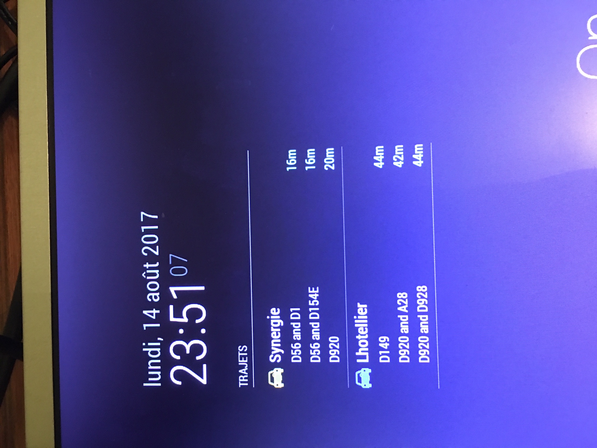

                      Hello,
                      I found why the module was not working. The name of my city is too long, it was necessary to put - between each name
                      Thank you very much for your help.
