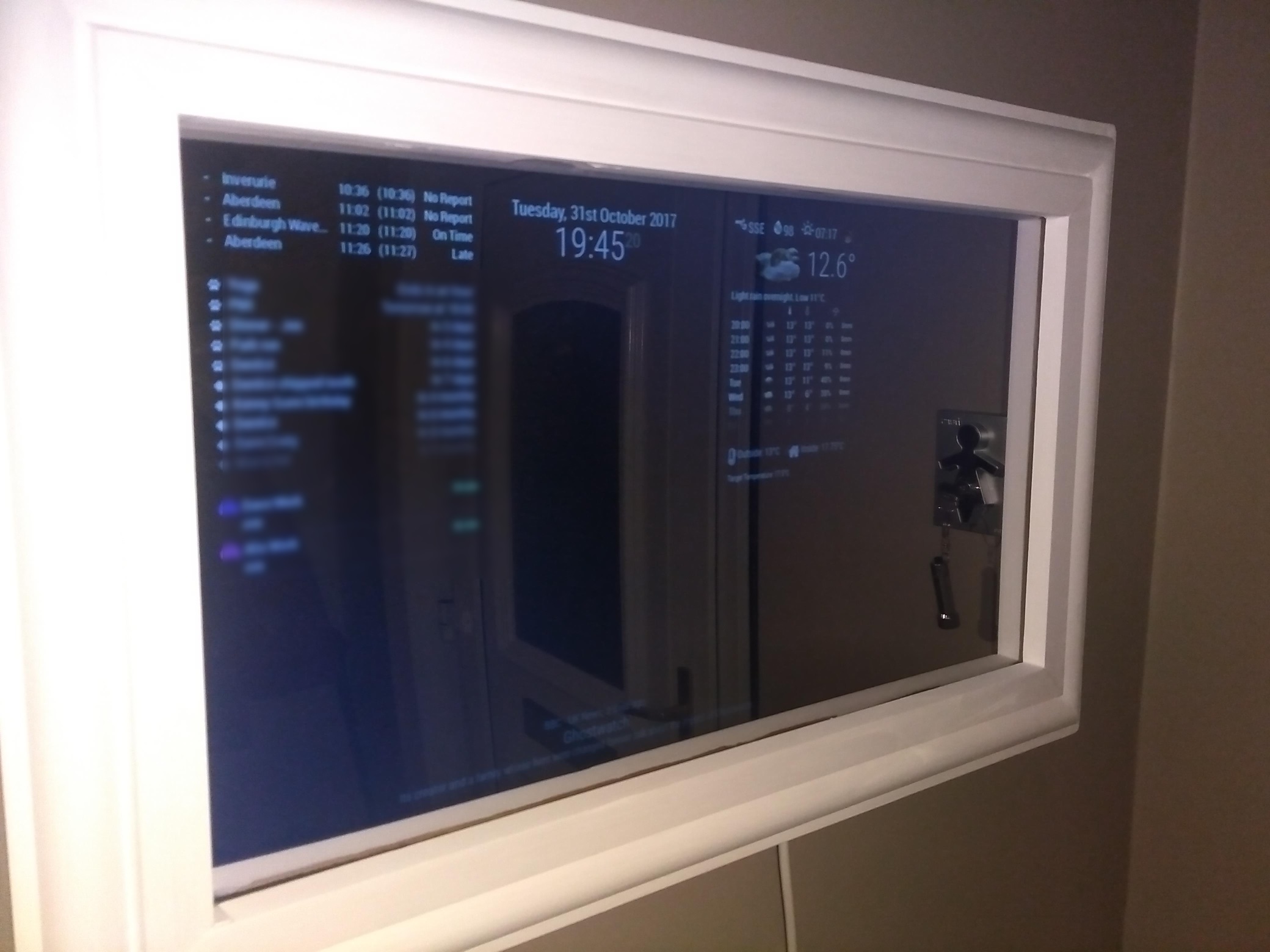

                                    @nwootton, Well after a full rebuild I still have never been able to get to the bottom of why it locks up. Still does it on occasion (Although it seems to be less frequent these days).
                                    I have a new weird bug with the train times for you now though! Recently (may have been since the clocks changed, although I only noticed it the other day as I was checking time on a train I was going to catch) I seem to be showing times an hour behind! It’s bizarre as I don’t think there are any settings anywhere in the mirror for adjusting times other than the PI config settings (mine is showing correct time & UTC if I run a ‘date’ command in putty).
                                    Any thoughts on what this could be?

                                            Ok, think I’ve figured this one out by manually loading the api json in my browser. The earlier train which is late is showing as being over 1 hour late (even though that’s not what it shows on the estimated departure time).
                                            This means that the trains following are still in the list even though they have departed.
                                            Either this has been happening every day atm, or there’s something screwy in the transport api database.
