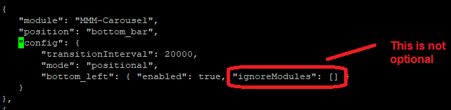

              khrusher @Gav
              @Gav
              I know this is an old issue, but I solved it…adding here for future readers
