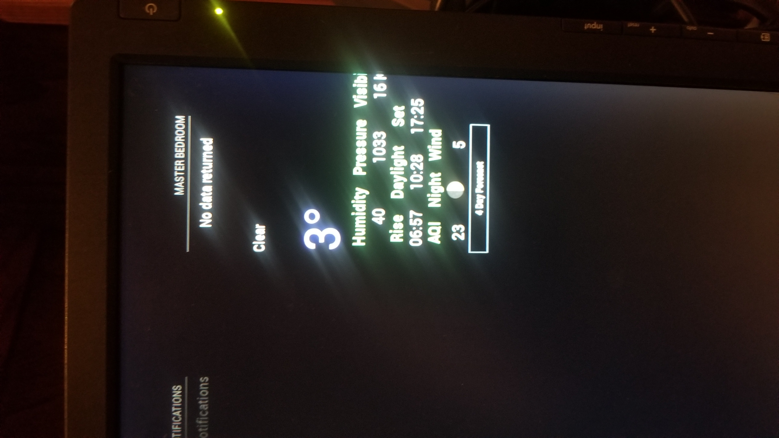

          • richland007R Offline
            richland007
            @cowboysdude How do i fix the formatting of this module please …have a look at the picture above it seems like its working but it is kinda jacked :)
            D
              richland007
              It does not give the name of the city but the weather background and the icon are visible… so the Name of the city and the 4 day forecast is missing also the alignment is messed up with large letters is not properly centered at all
              D
