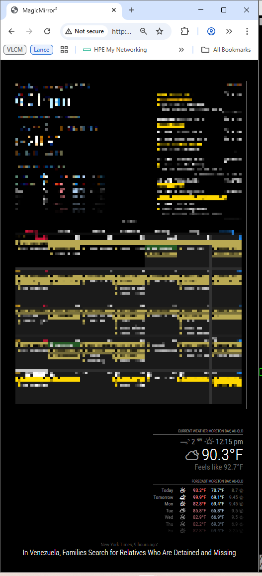

      Ok - so I tried the following - still said “Loading…”
      Replaced it with the same location as my local area and it came up.
      Restored it to the Australian location and now it’s working :/
      The only thing left is that it’s still displaying in Fahrenheit for Australia even though units are set to metric for those modules.

    • Default weather module - only showing one location
      Newb.
      Have my MagicMirror2 up and running with a few different modules. I have local weather working with openmeteo. Trying to add a second location (bottom_right) but it stays stuck on “Loading…”.
      I set up an openweathermap.org API key but I don’t get any weather data using the openweathermap provider for local or remote locations
      Should I be able to see multiple locations?
      Current config below. I’ve also tried a copy of the openmeteo modules to get the Brisbane weather but it did not work.
      I searched for similar issues but couldn’t find anything newer than 2022 and the advice on that post didn’t help.
