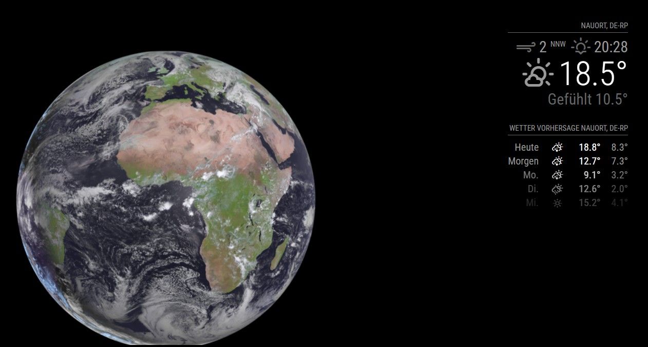

    • RE: Faulty temperature display?
      @sdetweil said in Faulty temperature display?:
      @Phantomkommander i think Germany would be +7…
      After your advice, I checked the data again and you were right! I have no idea why I put - it there. :D
      Thank you for your patience.

      @sdetweil I just entered the coordinates, which I found from a website. See image
      P

    • Faulty temperature display?
      Hello everyone,
      Yesterday I created a container for Magicmirror in Proxmox with Ubuntu 24.04. It’s working relatively well now. The only problem I have with the standard “Weather” module is that it doesn’t show me the “correct” temperature. The problem could be related to the fact that I live in Germany. Where I specified “metric” as “unit”. Can you maybe help me?
      Attached is a picture of the temperature. However, we have around 30°C at the moment.
